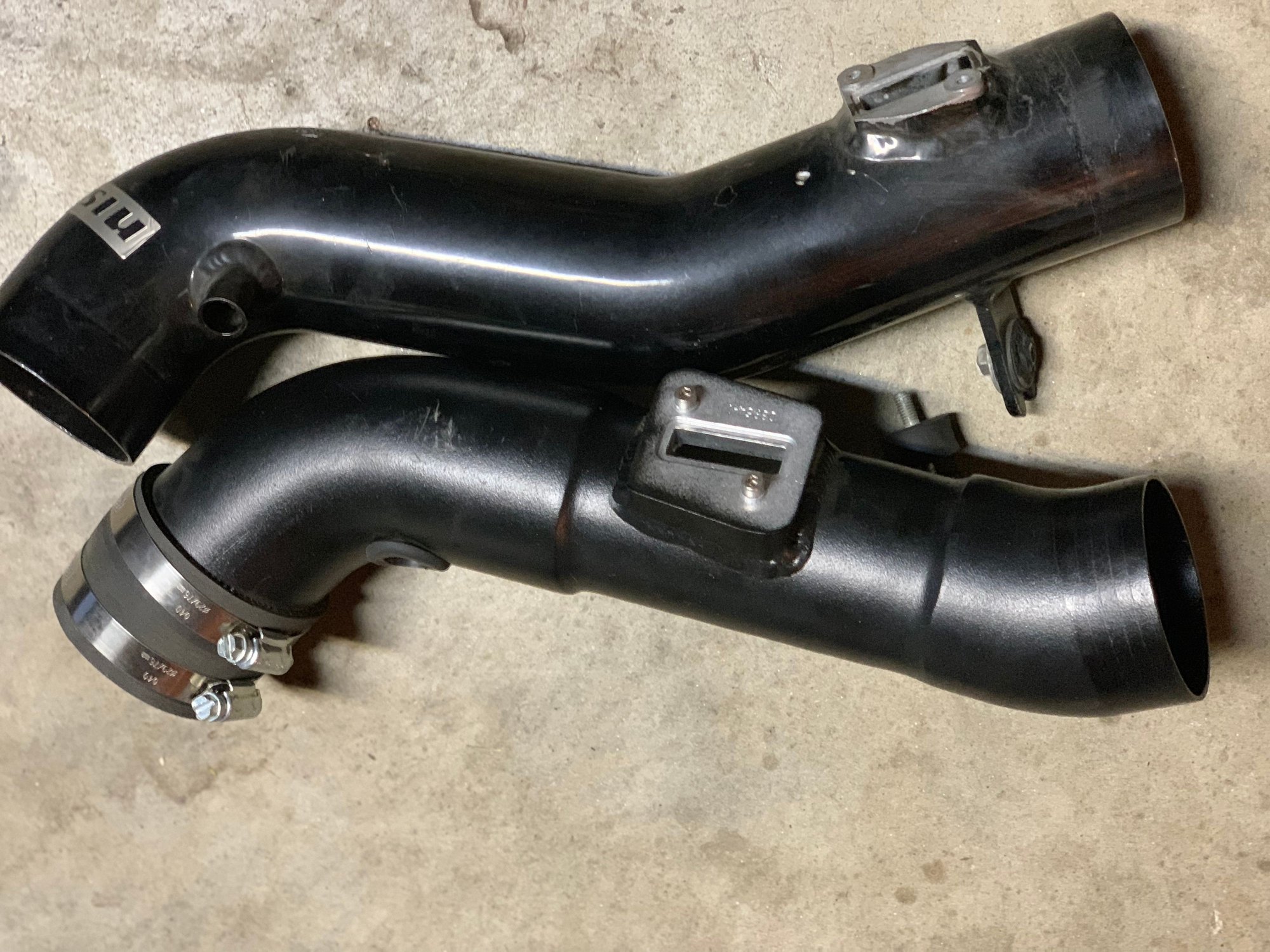

I found that the older NISMO intakes were not made by K&N. The new NISMO intakes are an exact copy of the K&N. I’ll post pics this weekend; I found an older NISMO intake.
Yeah, the DE intake was definitely an AEM piece. I know cause I have one, lol.

You can see how the K&N NISMO intakes step down at the MAF junction, the AEM NISMO intakes do not. Also notice the K&N uses a hole with a gromet for the PCV on the driver side, the AEM uses a tube like the factory intake.
