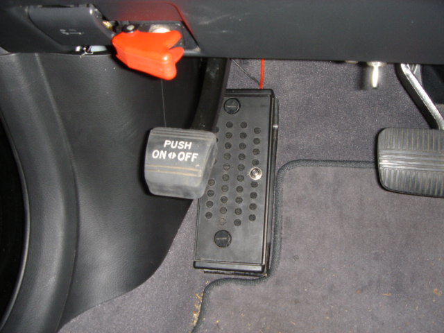

I wired a push button to my throttle position sensor that turns off power when held down.I mounted the buttonon my foot rest.(I have an auto)
the nitrous kicks in when I let off the button,then the WOT sensor and window switch do the rest.
Attached Thumbnails how do you avoid spraying in 1st with a WOT switch?-dsc00776.jpg
Very interesting setup, I like it.
