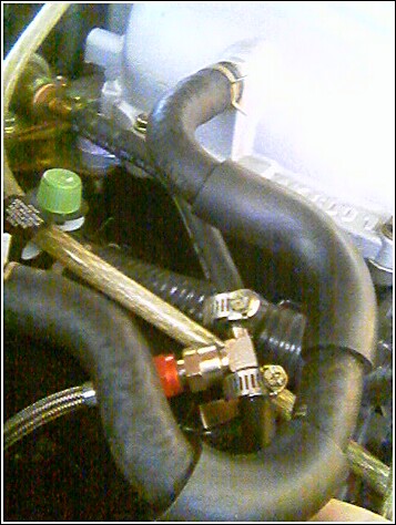

Old Feb 28, 2005 | 09:23 PM
MySunset350Z's Avatar
MySunset350Z
Posts: 1,712
From: Detroit / Las Vegas
fuel tap
Old Mar 3, 2005 | 10:47 AM
Tony@Performance's Avatar
Tony@Performance
Vendor - Former Vendor
Posts: 1,186
From: so cali 909-951-626
http://performancenissanparts.com/ca...oducts_id=2799
here is a link to the fuel T-tap that we offer. It is not recomended to cut that factory fuel line, even when we do installs on race cars here, we do not cut that line. Using this tap is much better and much more reliable.
the proper place to use this or tap into the fuel system is on the main pressure regulator, that is actually on the fuel rails, or just before the rails, under the plenum, in the middle of the heads.

Old Mar 8, 2005 | 10:08 AM
LaPuLaPu's Avatar
LaPuLaPu
Posts: 545
From: Corona, California
I believe this is the same SPX adapter that leaks. I’ve done more research into it and some people claim if you don’t purchase the connectors to the fuel line you will suffer lack of fuel, running you one the rich side. So I doubt I want to risk that. MySunset350Z, are you still spraying? More and more nitrous guys are moving into the turbo arena.

I don't think the charge to install the t-tap fitting would be too much. I would say about an hour to two at the most. but we are set with labor rates as is any dealership, and our discount to you forumites is $77 an hour isntead of $95.
plus the parts of course, which are not too expensive, and we have them listed on our site as well. It's an easy install if you want to do it on your own, you just have move thigns out of the way to get access to the main fuel pressure regulator on the fuel rail under the plenum

call up /Altered Atmospheres in Gathersberg MD and get their billet aluminum fuel tap block..DO NOT CUT that high pressure line , this aint no 69 NOVA here...

That is a matter of opinion. I ordered the Altered Atmosphere fuel adapter from you guys and it is a great little piece. While waiting for it, I went ahead and cut the factory fuel line, "t" it off, and we checked the fuel pressure at that point. It was 51 PSI constant. It is also 51 PSI constant at the dampner.
I will say this. The Altered Atmosphere adapter is very clean looking and a really nice piece that I haven't heard of one person having a problem with. The only reason I haven't switched to it is because it didn't come with the longer bolts needed to mount it. I kinda expected to get the bolts with the adapter because the site said that that it requires the use the 4AN fitting in addition to the adapter itself, but didn't state that I would need to buy the bolts seperately. So until I get some bolts, I will just stick with the good old tap that is working perfectly fine.

Your daddy was a very smart man. Did he know that more people were leaking fuel with adapters than "t" taps on the 350 Z? Like I said earlier, I have not heard of any problems with the Altered Atmosphere fuel adapter what so ever, but the fact remains that more people have leaked fuel with fuel adapters in general than with the "t" in the fuel line.
Due to the fact that I know the AA adapter is going to work well, I have all intentions of tapping with it in the near future and using my current tap for the fuel pressure sender.
I do however appreciate your insight on my possible fuel leak and fire! I'll pass the word to all the guys with the leaky adapters.

The leaking you speak of was on the SPX adapters which were NEVER intended for permanent fuel flow usage.They are actually a Nissan service tool to do fuel pressure checks,but you probably knew that right..They did not come with spacers and most leaks were caused from when they were installed people chewed up the "O" rings, but you probably knew that also right..
The AAM fuel adapter is specifically designed to tap off the fuel supply at the regulator for a guage or fuel line.It does not require spacers and will not leak.You method of cutting and splicing a high pressure fuel line is primitave and down right GHETTO and will fail at some point so carry a fire extinguisher in the car..If your method is so safe then why do all the fast cars do it the right way??

My SPX fuel tap has been working flawlessly for about a year now and I bought it used from another forum member. The only possible problem with the SPX adapter is that the ears that the bolts go through on the OEM fuel connector do not have any support under them with the SPX adapter so over-thightening "may" cause leaks.

i t-ed into the fuel line 2 summers ago and have not had any fuel issues. fuel pressure has always been at a steady 52psi, around 50psi at wot.
i originally had ordered the spx adapter and decided to t into the line while waiting over a month for the part to arrive. couldnt wait, dragstrip was calling.
yes, still running nitrous.
