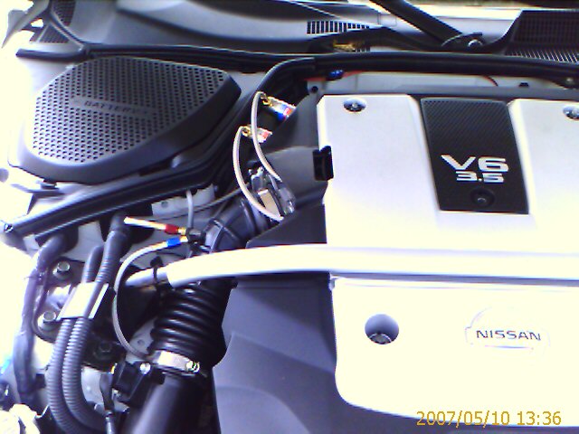

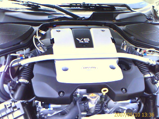

I dynoed it today at school and for baseline i got 263 whp- 235 ft lb tq and then sprayed and got 316 whp and 311 ft lb tq. when warmed up and did couple more runs and got the same number. Then i went to lunch and came back and ran again when cold and got 307 whp and 330 ft lb tq to the wheels. I decided to run a 50 shot split 25-25 in each intake. I will putting in a 75 shot next week. The printer was not working so i could not a get a print out. But i will try to get it by tomorrow and post it up I got a couple pictures of the set up

yea 50 shot didnt put you in the seat as much but you can still notice it

i did the setup myself my teach from school mounted my full throttle switch for me and i dyno it at school cause i go to UTI Norwood
