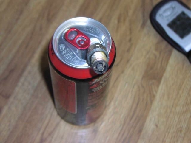

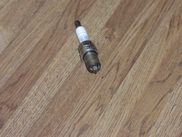

Culprit?
The installer who did my ZEX Kit used the 2 degree off ZEX plugs (no problem there) except he put the n20 jet on the fuel side and vice versa when we upped the jets to 100 (same time pulley's were added.)
So.... The plugs are melted lol. All 6 of them.
Not one Nissan Dealer even carried the STOCK heat range plug!
Long story short is that my car is staying at the Dyno Shop over night (good people) and all 6 melted black plugs are pulled.
We spent 2 hours finding 2 degrees colder plugs and we have the jetting right and the UR pulley's back on.
So, tomorow morning will be tediuos but I am off.
Pick up the plugs at 9am, go way back out to my car in Orangevale.
Have new plugs installed then redyno.
Long story short, it was the plugs.
However we can't rule out pulley's either because we can't do a proper dyno with melted plug electrodes!
Back at it tomorow. This will prove it tomorow because we went and bought the right jets and I always wondered if the installer for ZEX bothered to change my plugs and now I know hee did so that won't be stuck in the back of my head anymore.
But for now nothing but missing on the Dyno until we change the plugs tomorow.

By the way here is the over heated ZEX plug.
