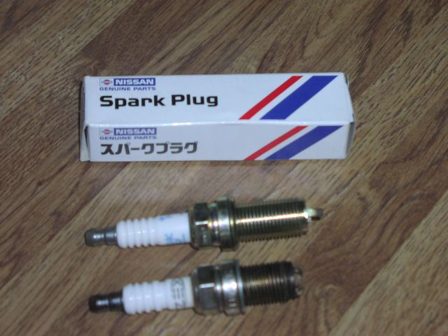

220 HP, 360 or so TQ 4k rpm signal loss to ECU and it falls on it's face at EXACTLY 220 HP every time. UR pulley's or stock pulley's.
Bottome line is UR Pulley's and ZEX Combo works!
BUT.... Now here is where tomorow's Dyno comes in.
The ZEX plugs are the only thing left from Dyno 2 to Dyno 8.
3 different sources say that it's the triple electrode causing the ECU to think detontation like a misfire (that bad.)
One person also said the ECU is soooo sensitive that even taking out the platinum effects the Dyno (ZEX plugs are not Platinum.
So tomorow a summary with Dyno charts with new NGK Platinum plugs 1 degree colder, already in my hand all 6 of them, but have to go to work.
Till tomorow rest assured that ZEX and UR work together and just good luck finding plugs, but the COMBO works!
Dyno charts tomorow for now here is a pic that should show part number and both plugs!
Good Luck,
Till then Peas!
Party number doesn't show will post it tomorow bought them from Nissan Dealer too! NGK Platinum one degree colder.

P,S, Here is that hard to find Nissan one heat ranger cooler plug, dealers can get them in one day if they are not in stock,
NGK Nissan part number 22401-5M016

ZEX plugs fouled again will post later have to run to work then off for 3 days bereavement.
Bottom line!
325RWHP 370TQ!
Plugs were culprit, STILZ you can chime in and slam me but I don't care I am flying so high nothing is bringging me down.
