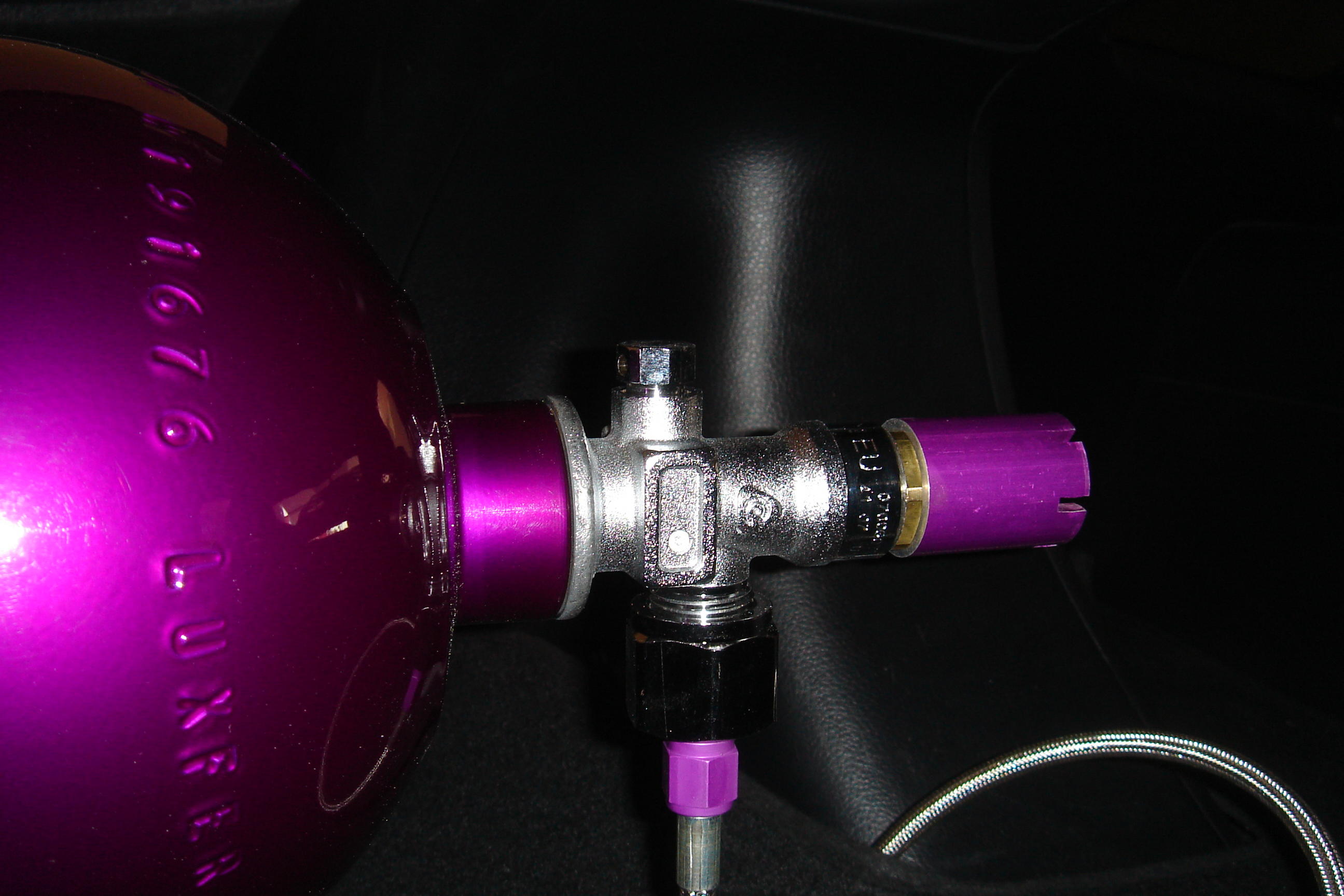

For those that have an electric nitrous pressure gauge, did you need an adaptor to mount it to the bottle? Looks like there is a bolt on the other side of the nitrous outlet that might be able to take the nitrous pressure sender but it looks like a special bolt that I shouldn't mess with. Advice? Thanks.

So I guess those ports are just for extras for the bottle. Mine is not that brand, mine is a Zex. I'm thinking that the bolt I was thinking about putting the sender in place of will be ok. It's the shiny bolt on top in the pic, opposite of the nitrous line. What do you think?

I guess the port at the top is for the blow down tube, so I will try to see if the threads are the same for the pressure sender tomorrow.

As mentioned above, if you have a bottle that has 3 outlets, then you can use 1 for the nitrous line, 1 for the blowdown tube, and 1 for whatever else you want (i.e., pressure gauge).
I see that you have the ZEX bottle, but don't fret. You can always get these adapters that allows you to share one port among multiple things.
