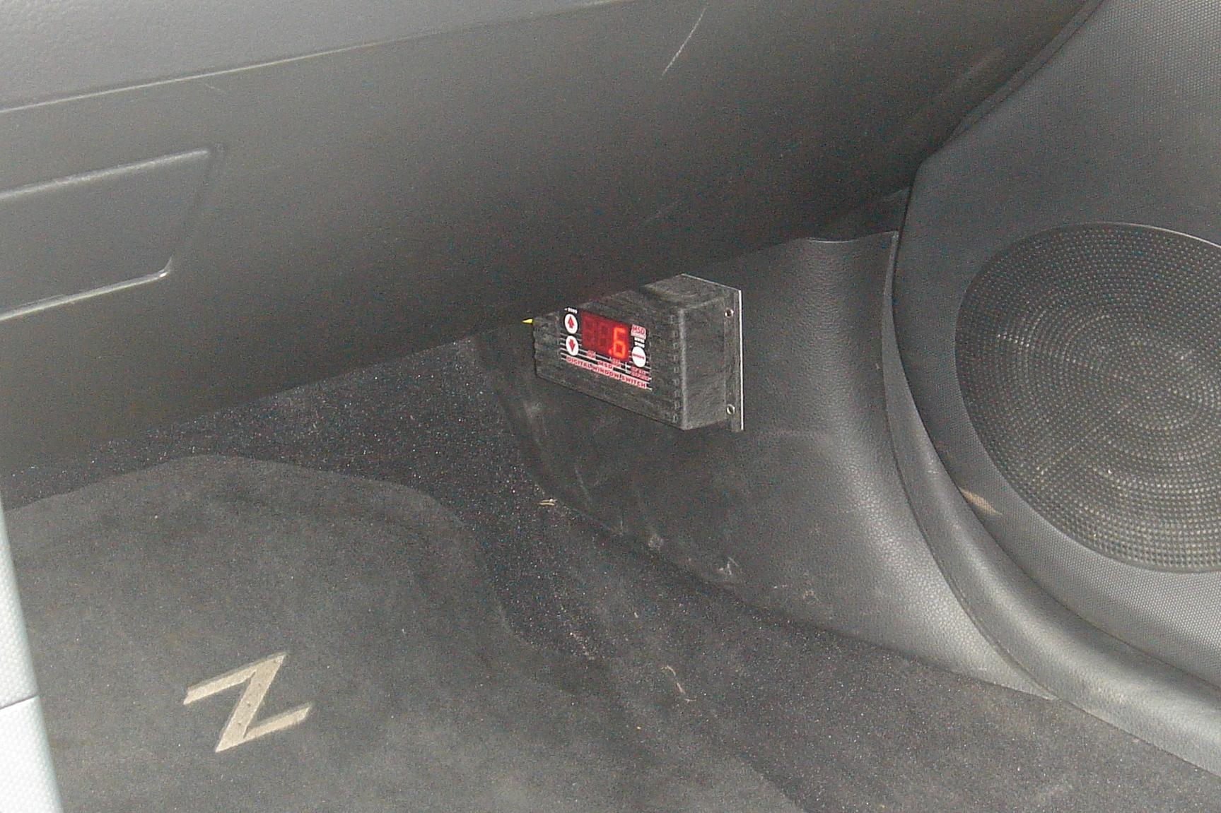

Here's my new nitrous install. It's the Zex kit that is specific to the Z. I also added on a Zex remote open, Zex purge kit, Zex bottle heater, MSD digital window switch, and a Autometer electric nitrous pressure gauge on the a pillar. Thanks to those that helped out in the threads I started and the old threads that I searched in. It's not quite as nicely installed as some but it will get the job done.

Just curious. Why'd you choose those places for bottle (lose trunk space), MSD switch (weird location), and the buttons (arm might hit them accidentally)?

I put the bottle there to keep it off to the side and still have it in a position that the instructions wanted. The MSD was put there so I can adjust the on and off rpms whenever I wanted to since I'm not sure if I will keep it there or if I will move them around a little. It's attached to the side with some velcro so I can pull it off and adjust easily and not getting under the hood or into some special hiding spot. The buttons were going into the cubby where the smart people put them, but I wasn't trying to hide them so I put them somewhere easily reached, and they are, except that my elbow does reach them on accident sometimes while I drive. But only barely so I will keep them there.
Thanks for the comments, guys. I wish I could tell you how much I love it, but I won't get a chance to get nitrous for awhile. My R&R is over and I'm heading back East. Not to mention that I just found out that nitrous is illegal here in Germany.

Thanks for the photos! I like the management unit location. I'm going to install this kit next month.
