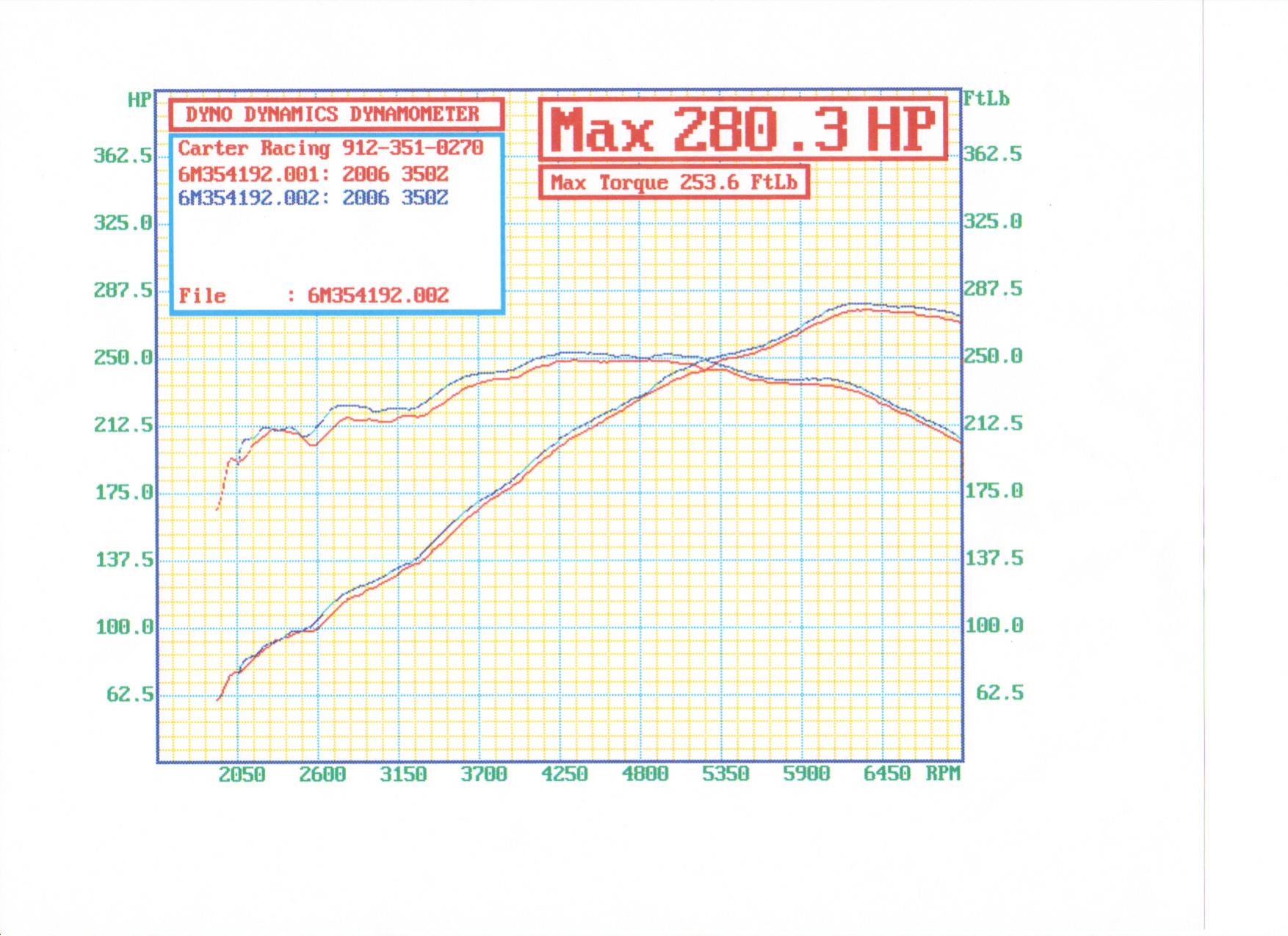

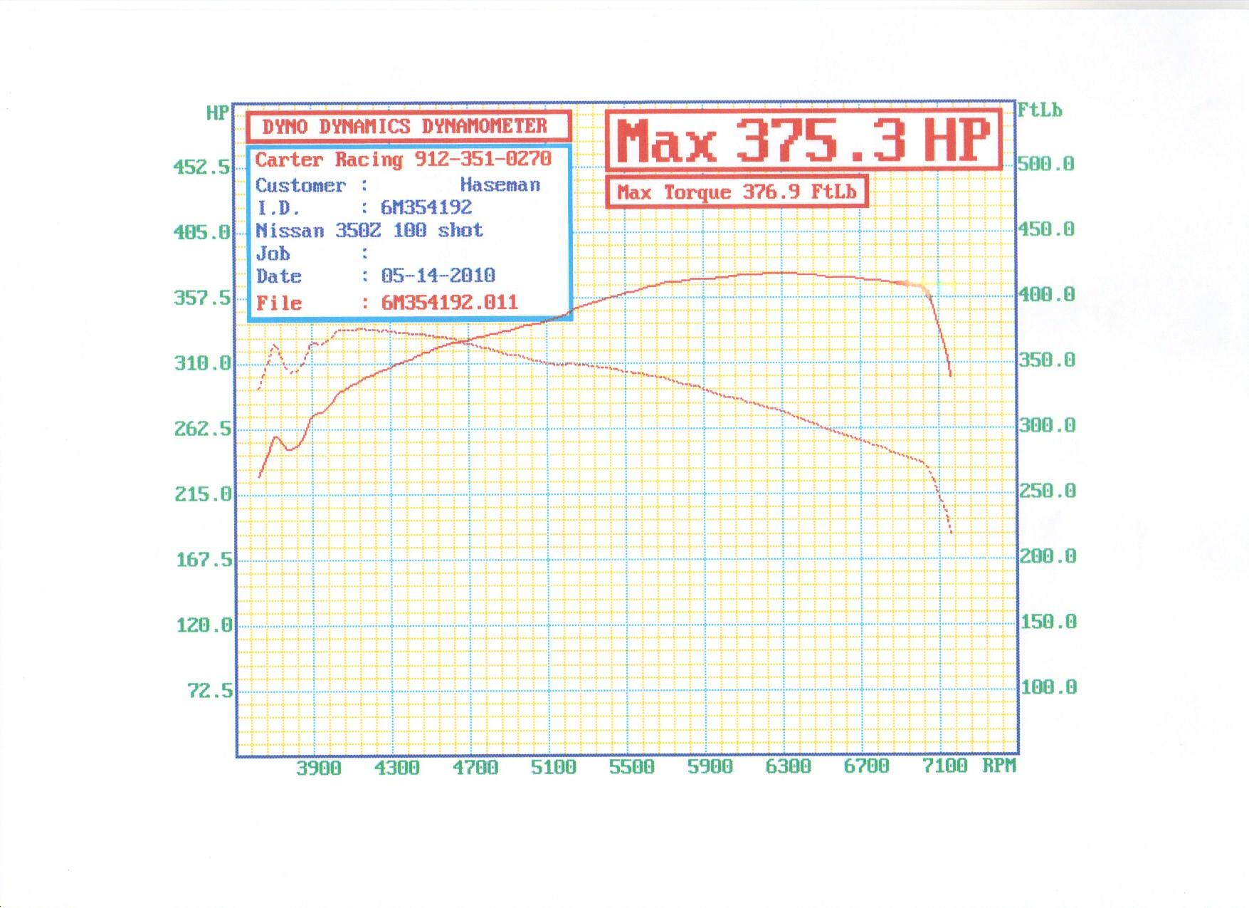

Just got the car dynoed last week and the AFR was lean..did not have the fuel hooked up. So I hooked the fuel up and AFR looked perfect. My numbers before with just the mods where 280whp (baseline was 239). When I hit the dyno yesterday with the fuel hook up I laid down 375whp and 376 WTQ. Not bad and the thing takes off like a rocket! I paid a little over 700 with purge and fuel tap and 250 for the install.
What do you all think?

good numbers... what mods do u have where u put down 280?

JWT pop charger, motordyne plenum spacer, stillen grounding wires, kinetix straight pipes, injen true dual, agency lightweight pulley set and hypertech reprogrammer

what size jets?

52 and 31

No mrev2 and i disconnected the hypertech before I dynoed with the spray, the hypertech is pretty good if you don't have a bunch of mods

Nice numbers..!

Thanks man....I haven't changed the spark plugs yet, but I think I need to. I also think I could have squeezed a little more out of it.
It was like 93 degrees when I got the dyno and very humid... but I have been embarassing GTO's and 2010 Camaro SS’s...
