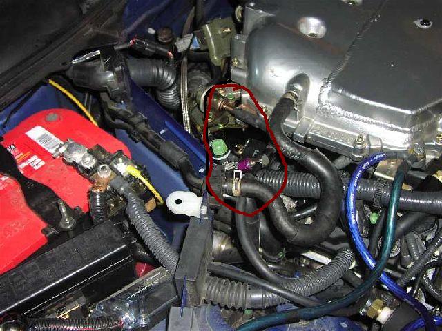

hey guys me and a buddy of mine are gonna instal a nos kit in my z. its a wet kit,my only question is where is my fuel line,how do i tap it and what do i have to get to make this work thanx for the help

This is where I did mine with a EFI Kit from the local auto parts store into a T type setup.

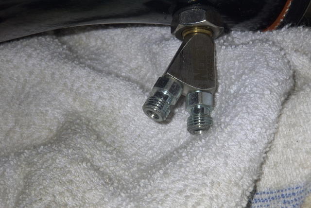

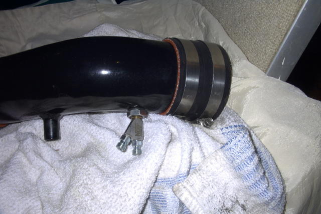

TB Tap for Y adapter that holds jets

i can abrly see it damn. mike could u run dwn the basic insta for me thanx

Just follow the starting point in the fuel line circled at the top of the engine or else buy that adapter kit that is always back ordered

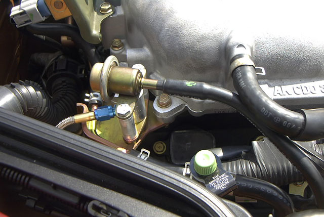

This is the preferred method..it cost you $30 and the car can be returned to stock without a trace..Pleased do not cut the fuel line!!!

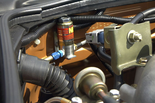

Good spot for the Fuel selenoid....
