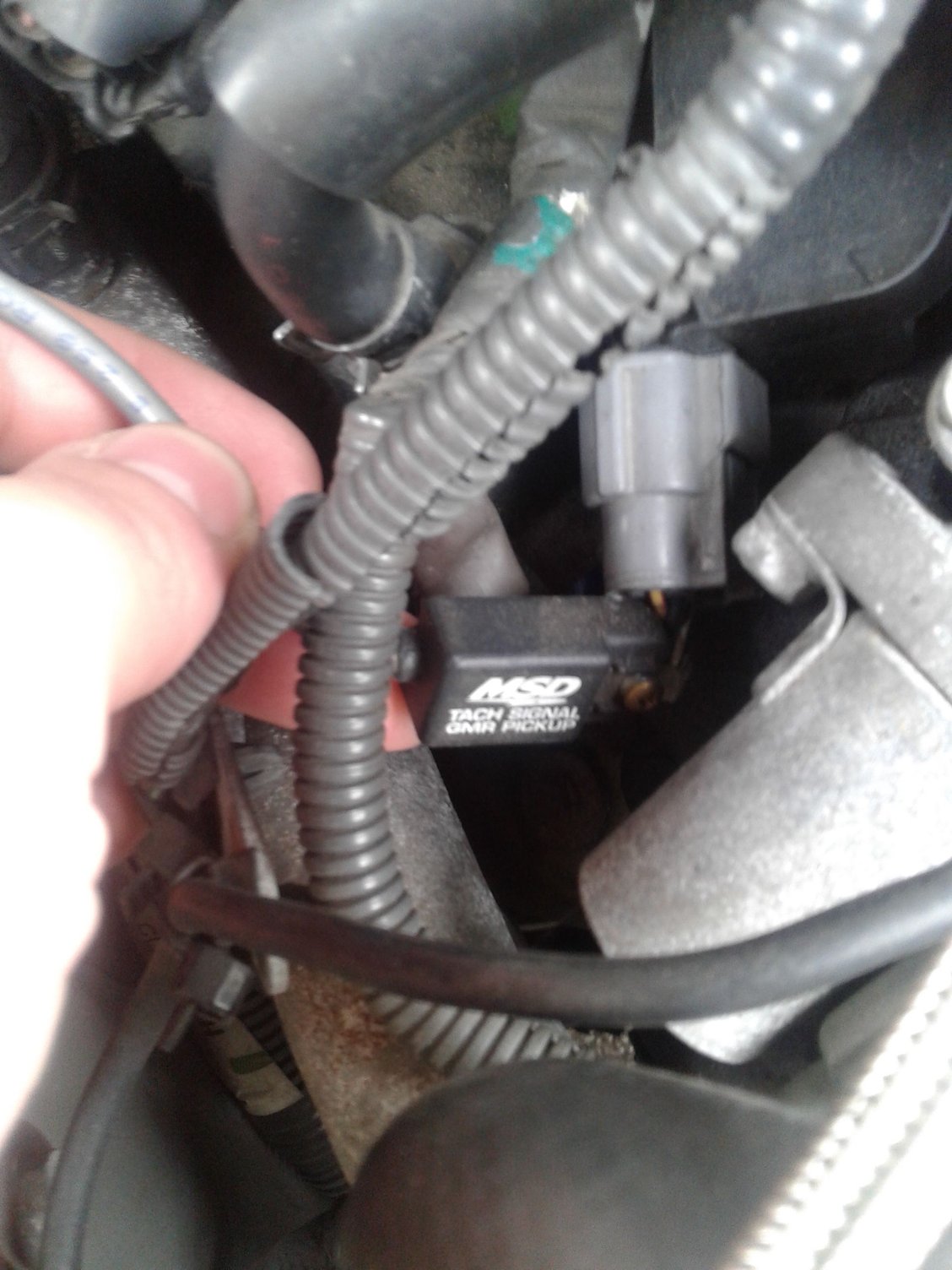

Should I have any problem picking up a tach signal from ECU Pin 62 (Ignition coil No.1 which is also Pin 1 of connector F203) for my MSD 8969 Window Switch? Thanks in advance for your help.

The kit is complete, but...it only works if I bypass the MSD 8969 Window Switch by providing a temporary ground to the Nitrous Management Unit. The window switch is operational and reads the correct rpm when in use but is dragging my idle rpm down when I arm the system. Further trouble shooting will continue but...my daughter is getting married this weekend. The 55 HP shot sure is sweet! See the photos here and thank you for your interest: https://my350z.com/forum/2003-2009-n...l#post10988272

You need just put these part on your cyl 1 signal
