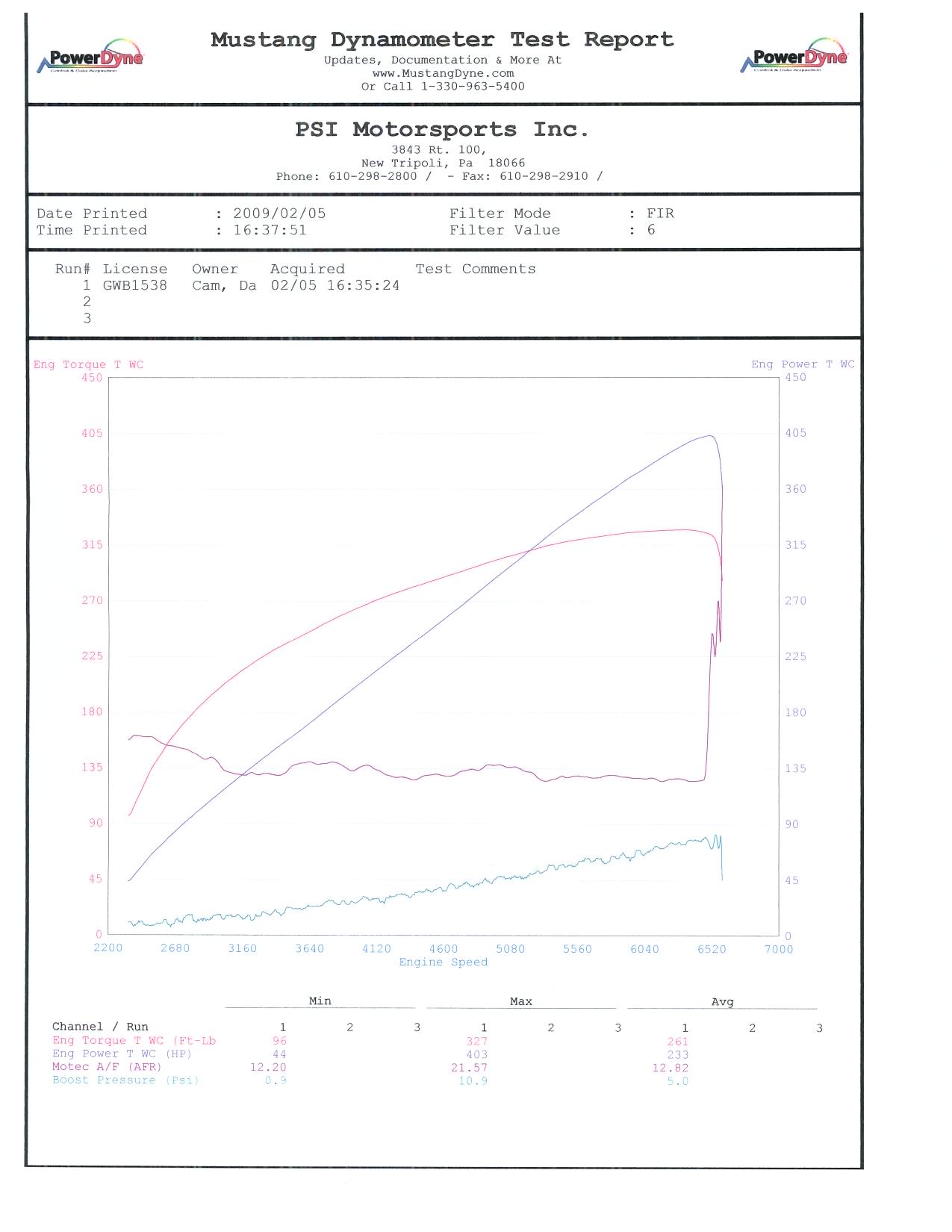

almost all done...
rc 440 injectors
walbro 255l fuel pump
1/2" motordyne plenum spacer
smaller s/c pulley (3.12)
tune
new front bumper and paint
injectors, fuel pump, spacer, and pulley are on. i will probably have it tuned this week! new bumper is coming soon!

Do you have a return-style fuel system? If not, maybe you should go with 550s.

i have a FMU. car is getting dyno'ed on thursday. i am aiming for 400whp

I have a similar setup.
Stillen TD exhaust
550cc Injectors
Utec
Kinetix HFC
AAM plenum spacer
Vortech w/ 3.12 pulley
I pulled 378 DD. I don't see why you shouldnt pull 400. Goodluck man!

besides the spacer, i also have headers, test pipes, and jic magic spartan ST single exhaust. got my fingers crossed for tomorrow. if i dont make close to 400 whp i am going to

got my car dyno'ed today. 403whp, 327tq on a mustang dyno.
