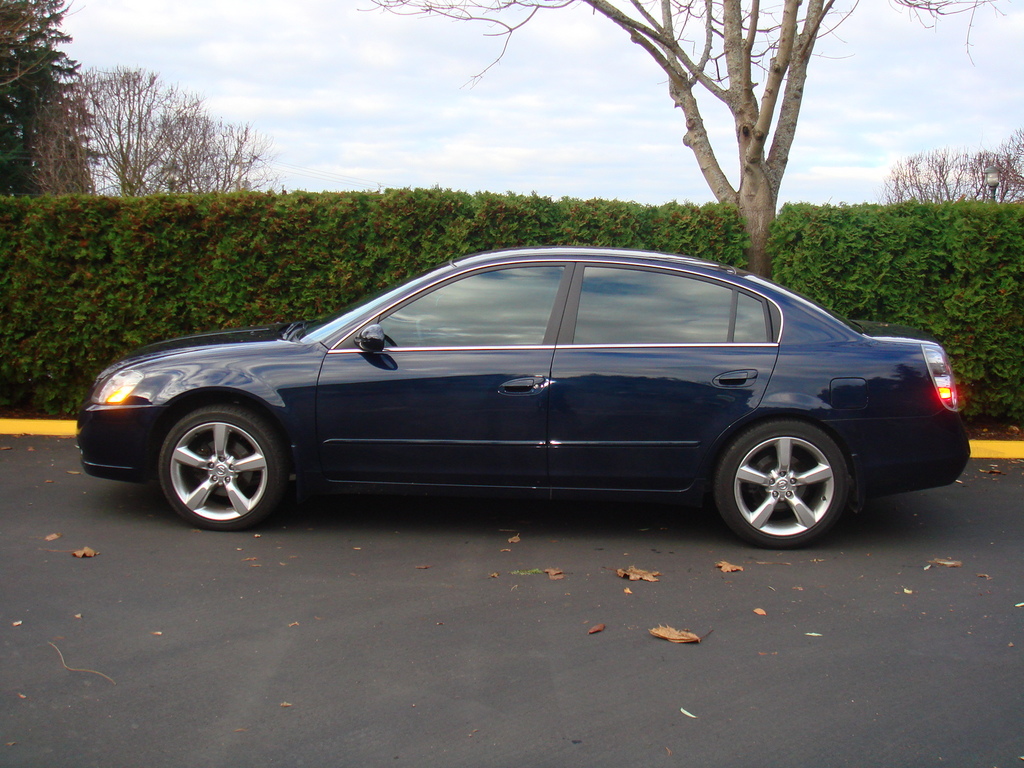

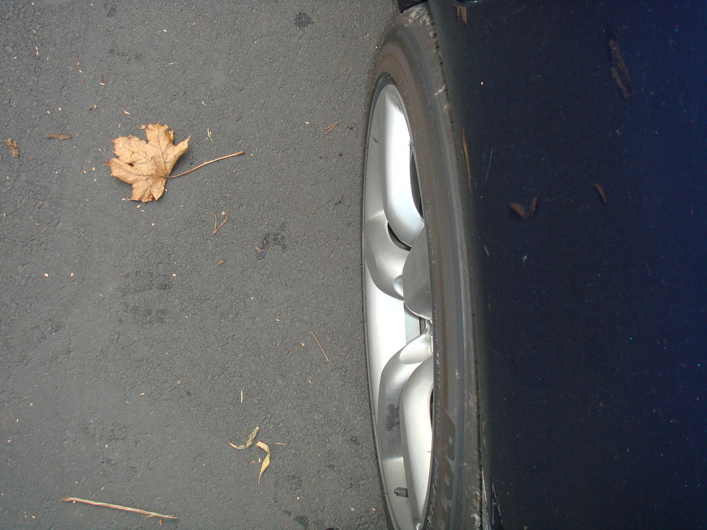

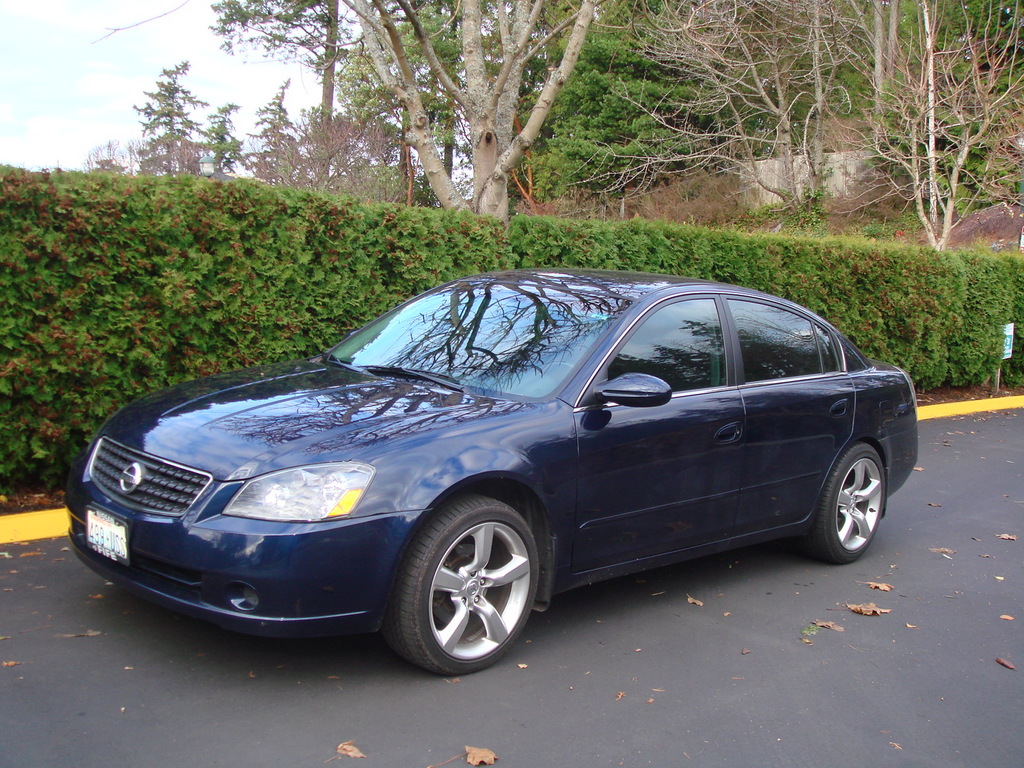

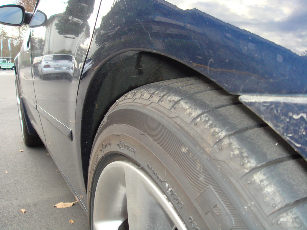

alright, here is what it looks like.
Attached Thumbnails my altima is going to need some help-dsc00506.jpg   my altima is going to need some help-dsc00505.jpg   my altima is going to need some help-dsc00504.jpg   my altima is going to need some help-dsc00503.jpg

well, i was thinking about it, but first of all the tires are brand new, and second 225 would look tooooooo stretched. however, if i roll the fenders it will resolve the rubbing issue, and yeah it rubs quite alor especially when there is a third person in the car, dont wanna think if there were four. also, this is my mothers car, and she has been telling me about this for a while, and i promised her to take care for the rubbing preoblem, so i will have to find someone to roll them.

Instead of a 45 series tires, go with a 40. That should help. Lowering will add on some negative camber which also helps. Switch the rims around. Put the rims that were on the front of the 350Z in the REAR. Put the rims that were in he rear of the 350Z in front. For some odd reasons, the rear tires look beefier then the front in those pictures..

there is a thing called a fender rolling machine or whatever.
some people also use a baseball bat and roll the fender in REALLY REALLY slowly, it takes along time so you dont crack the paint.
