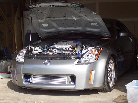

Here's the done deal

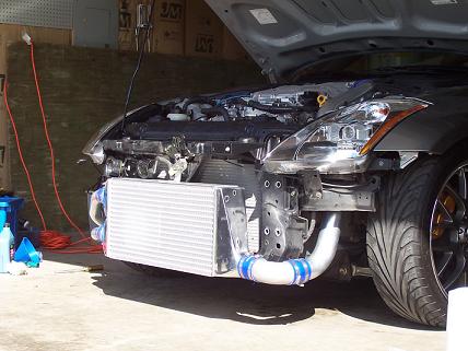

Ok figured it out. More pics

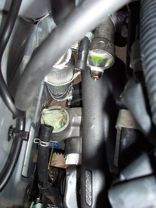

Here's a shot that shows how tight this thing is

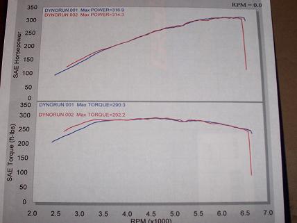

OK went to the dyno today. I only dynoed 316 hp and 290 ft lbs of TQ. The reason was that I was only making 4.7 psi on boost. After the fact I fixed my profec e0-1 and now make a solid 5.6 psi every time. Oh well I'll redyno after I get back in May.

Here's the sheet.
