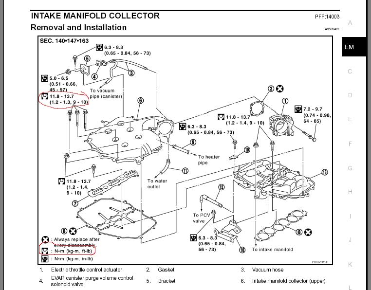

The 350Z owners manual states 44 - 61 on page EM20, I noticed that Tony changed the directions to 5 foot pounds but I imagine this has more to do with people not owning inch pound wrenches. Hey you guys do what you want, it's your car.

hmmm.. i guess the g35 manual is different. kinda odd because they both have the plenum and I would imagine the same specs. i will be attaching a pic for reference.

To convert ft-lb to in-lb, multiply by 12.
So if you have an in-lb torque wrench the required amount would be 108-120.
My ft-lb torque wrench starts at 25 and goes to 150 or 250, so it would still not work here. I just bought a 25-250 in-lb wrench from Sears this weekend for this mod.
Originally Posted by drsifu
edit: i see em-20...it does say 44-61 in lb, but refers to the "stud bolts".
which bolts are these and why does the diagram on em-17 show 9-10 ft lb?
