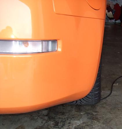

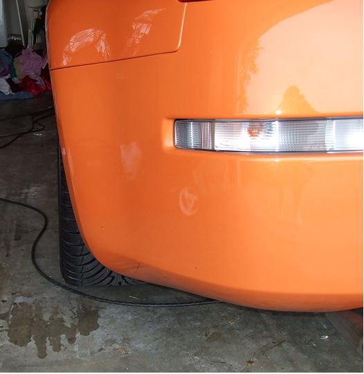

i want to do the mod but it will make my negative camber even worse wouldnt it.

well the rule of thumb the more drop the more negative camber so most likely yes unless you get a camber kit.
