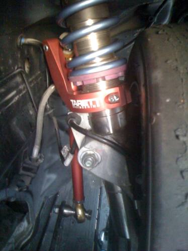

KW offers custom valving and swift springs fit just fine on their collars? Guess S2000 crowd isnt as creative as the budget Porsche crowd?
Here's my KWs with swift spring on my Boxster
I'm back to looking at JRZ now. Looking at spring rates of 650 lbs front and 550 lbs rear. Double adjustable RS. $5K argh but everyone says they are amazing.
