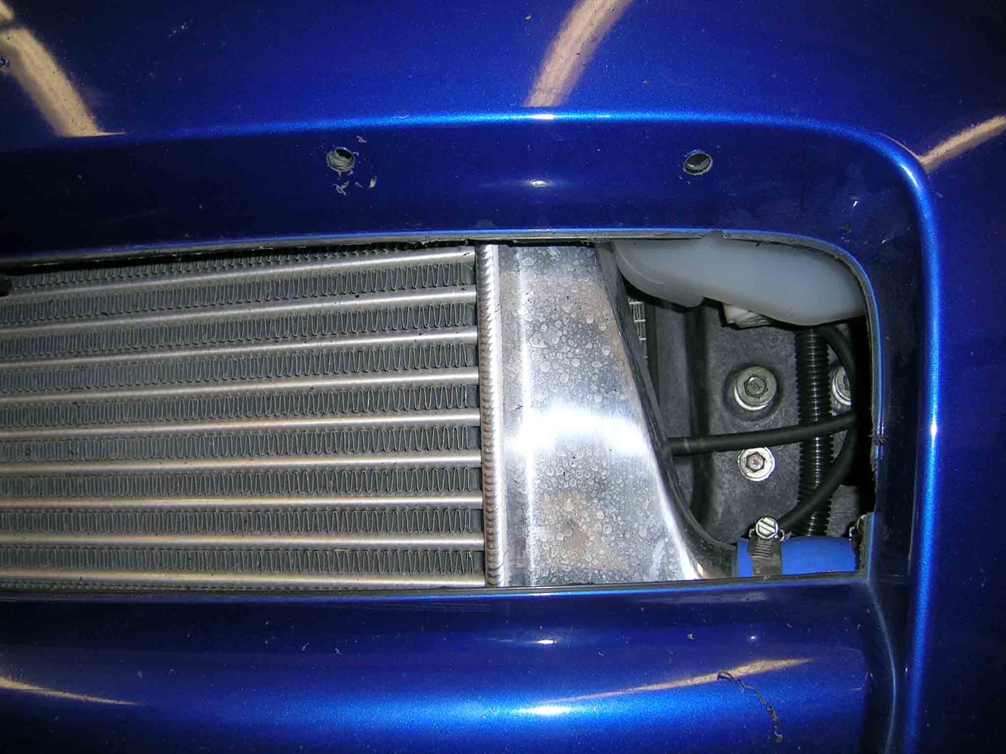

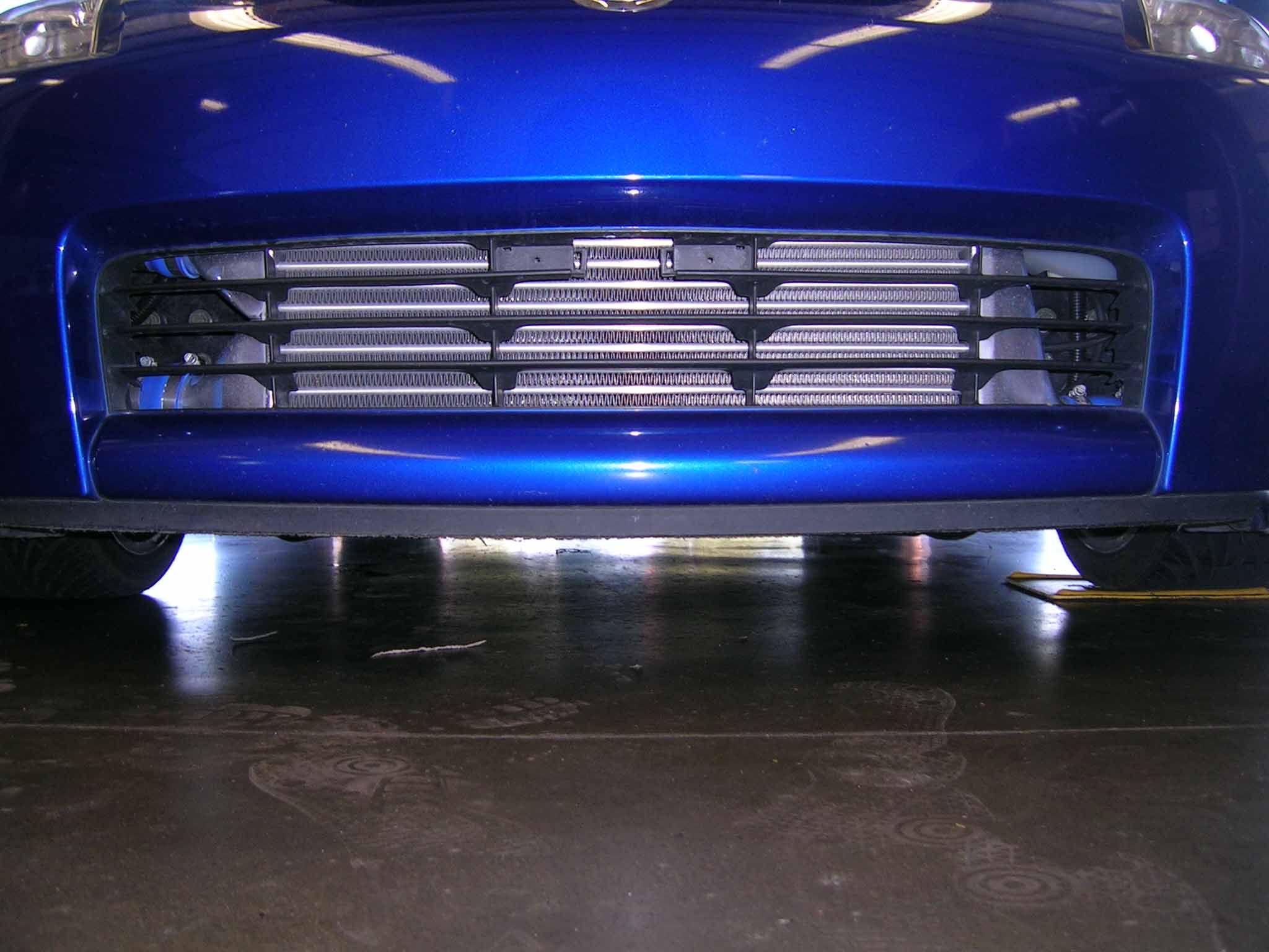

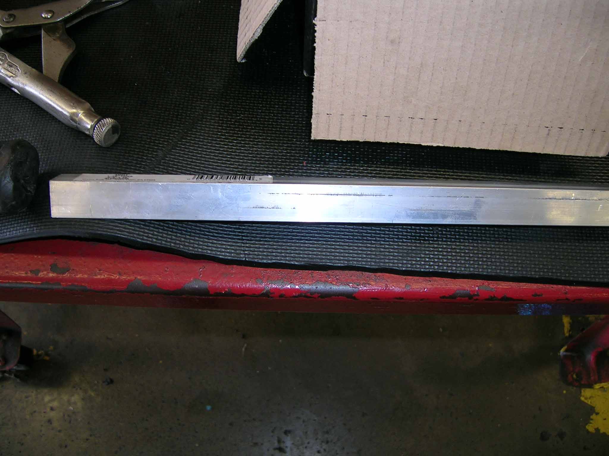

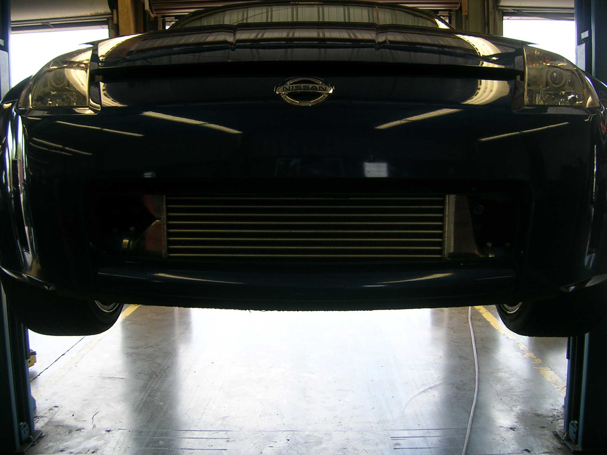

So I had to some way mount my plate and I can no longer use the Stillen tow hook plate holder (who wants it?)
So this was my idea: cut out the grill and make a bracket that will mount on the lip left by cutting out the grill.
One problem, F/N Safety!!! with it mounted there, the bottom is 8 inches (needs to be 12 inches minimum) from the pavement so it wouldnt fly. Not to mention the plate covered up a 3rd of the FMIC. So after fabbing a bracet I figured that out. So next I decided to offset the plate to the right so it wont block the intercooler and I can choose to mount it on the top plate hole or the bottom. Mounting the plate with the top bolts is not Safety passing so until I get my check I'll keep it on the bottom holes.

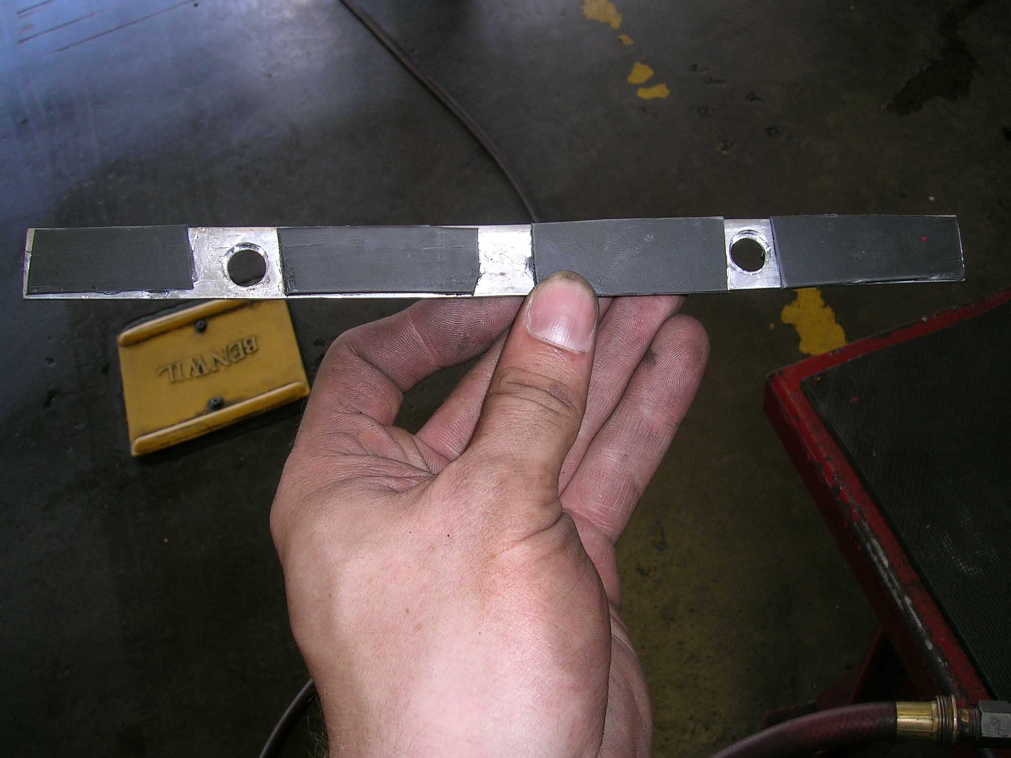

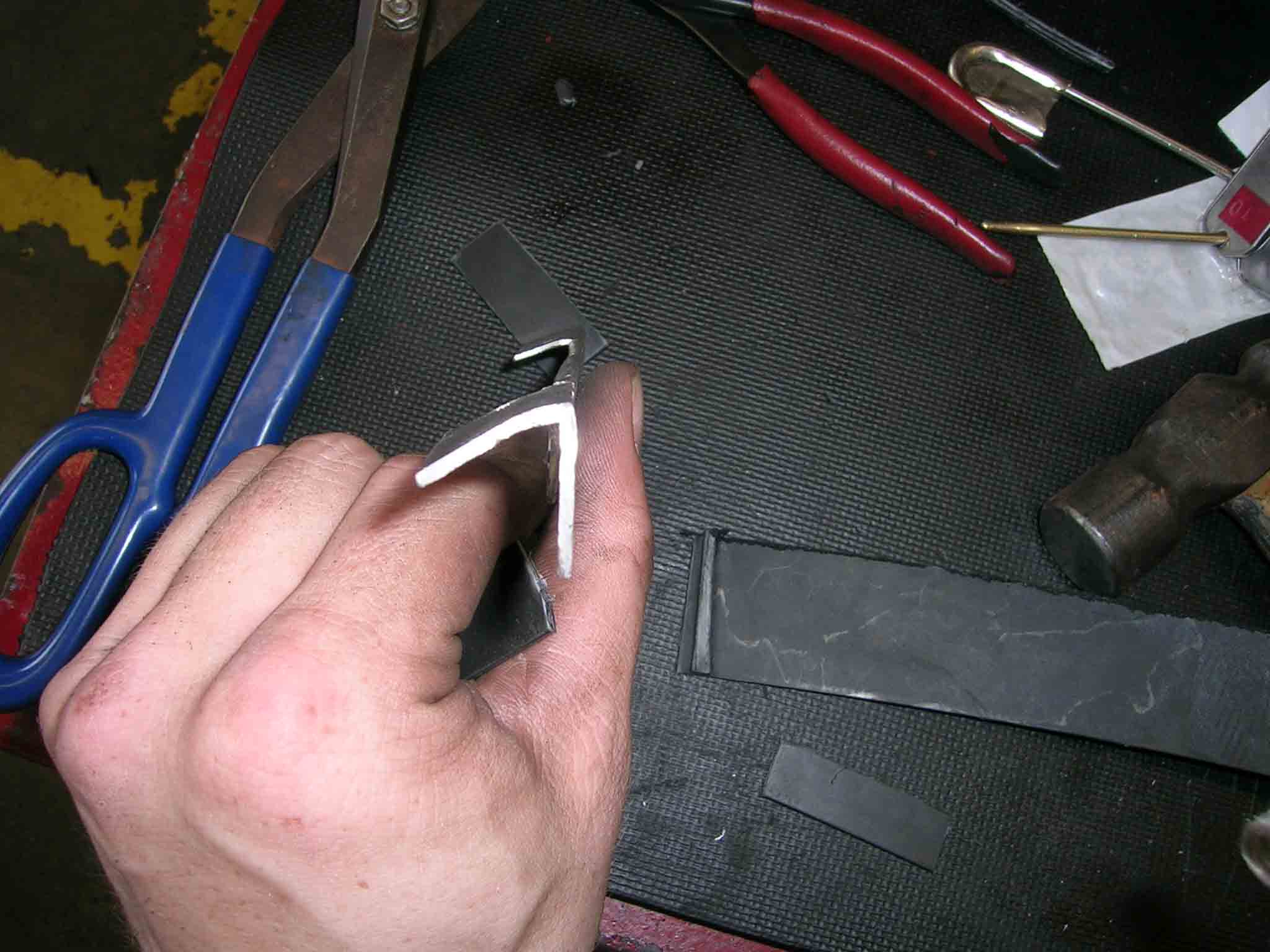

I went to Home depot and got Aluminum Angle Iron. Measured it out to fit the plate, linned up and marked the holes. Drilled out the holes reenforced the thin mounting side. Placed plastic spacers on bracket to keep the metal from scratching the paint. I ligned up the bracket marked and drilled the holes. All that was left was the mounting.
I'll try to get pics of the plate mounted lower to give you a look at how it sits.
Attached Thumbnails Licens plate bracket-open-grill.jpg   Licens plate bracket-angle-iron.jpg   Licens plate bracket-bracket-angle.jpg   Licens plate bracket-bracket-back.jpg   Licens plate bracket-dscn1571.jpg

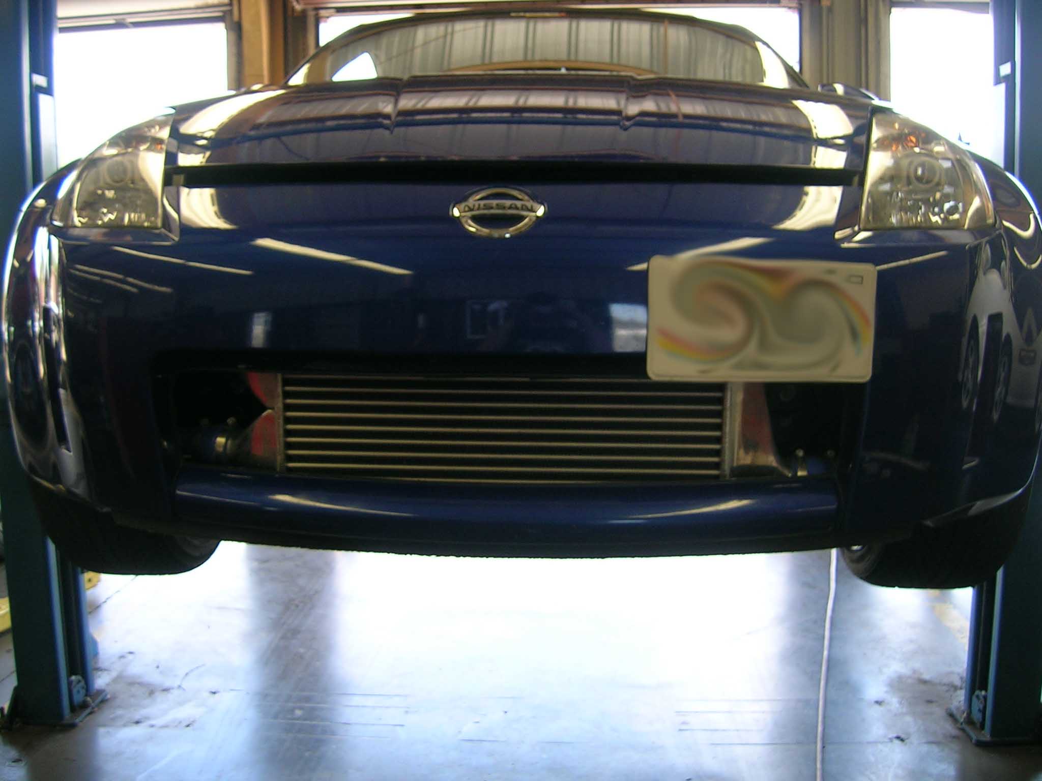

So Its all lined up and the plate does not touch the bumper. It just looks like it hover's there. Indecisive about it. It's kinda growing on me a little.
Attached Thumbnails Licens plate bracket-lic-bracker.jpg   Licens plate bracket-holes.jpg   Licens plate bracket-bracket-mount.jpg   Licens plate bracket-finished.jpg

kinda looks odd to me, but nice job of fabricating the thing. is that a crack in the bottom of your bumper?

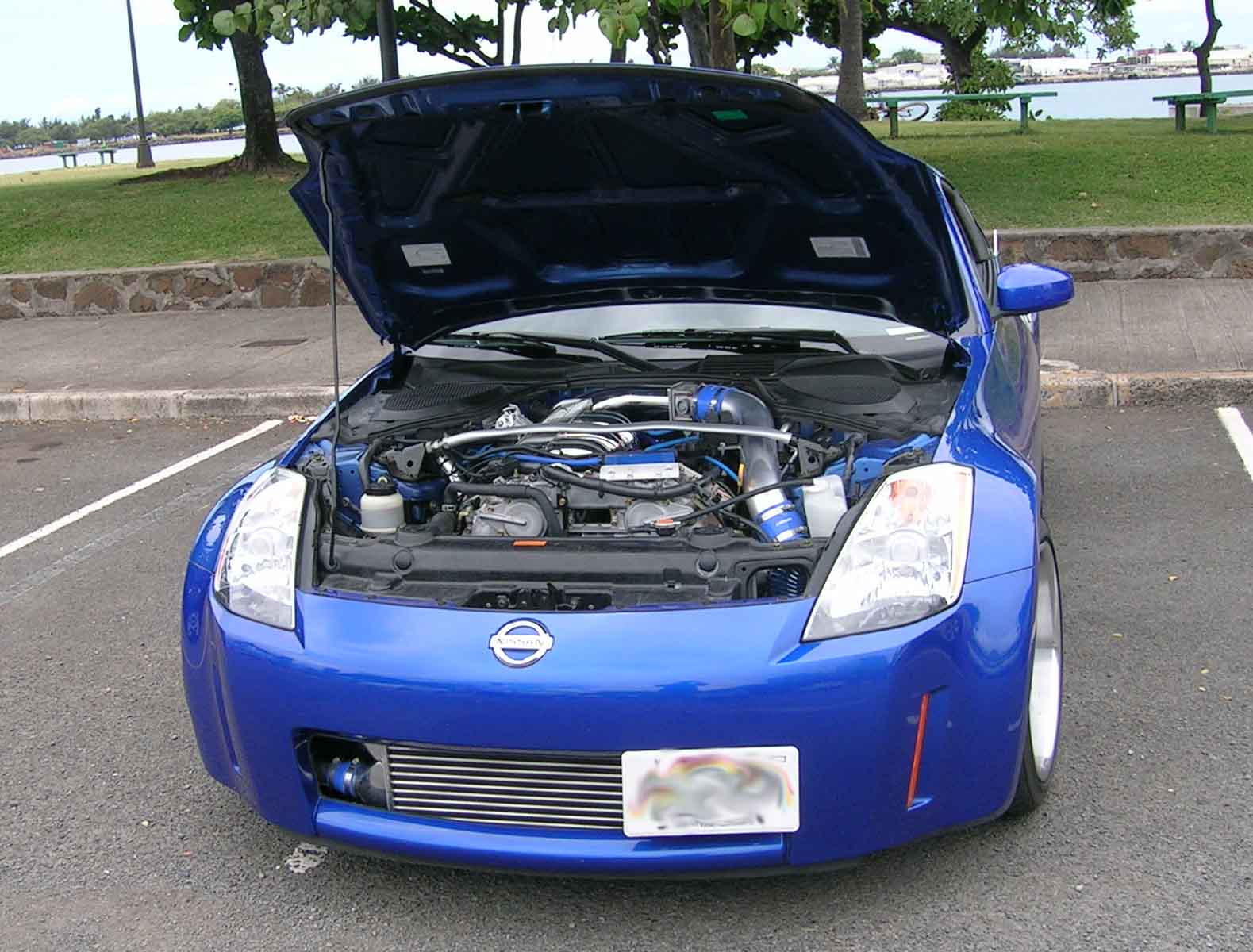

I moved the plate from the bottom holes to the top holes. It looks way better lower but still not like it was centered. I may try to cut the bumper, but not sure how to get the inner lip like he had. If I can get it that way I may think of doing it.

Here is the new plate mounted on th upper bolts.

wwaaaaayyy nicer man.
