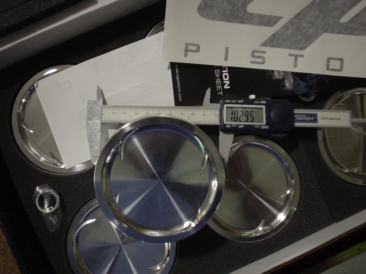

heres some eye candy you know you want it! 103mm bore CP!!
