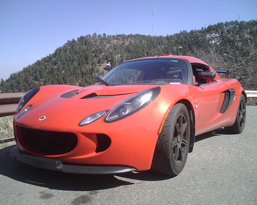

Take the $1000, sell your Z and buy a Lotus.
Old Apr 26, 2008 | 10:21 PM
Robert_K's Avatar
Robert_K
Didn't Go Cheap
Posts: 12,390
Likes: 101
From: Spring, TX
Your a fool Aaron!
Old Apr 26, 2008 | 10:23 PM
Amarao's Avatar
Amarao
Posts: 405
From: Colorado Springs
Please, you know it's hot!
Ross, did you meet a guy named Frank at Spring Mountain? He's a lotus owner from Boulder.
Yes but TT350Z > Lotus. But if I could own both I would.
Oh you crack me up Robert!
