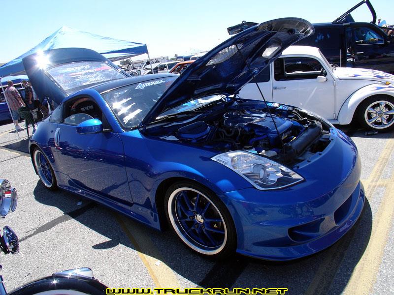

Couldn't help but to throw my $0.02
2006 upgrade WILL work without any further modification (other than what was previously explained).
I have a 2003 and upgraded to 2006 heads and tails... not just research, so this is coming from experience on a car that some of you have seen in person at meetings.
I bought my 2006 headlamps from Santa Monica Nissan, with the same story, they told me it wouldn't work and it was a waste of money cuz one of their guys had also done the research!
All I had to basically do is:
remove my old ballast and bulbs from my 03 lights
file as indicated in previous post. install my ballast and light bulbs... turn my lights on... and presto!!!!
Yes, the 2006 are bi-xenon... guess what, my 03 ballast work! It's the hardware/wiring on the actual headlamp assembly that makes it bi-xenon. The only thing I later did was upgrade my bulbs from non-projector to projector style because I wanted 9500k bulbs.
Here's a pic of the car, with the above mentioned:

How much did you pay for a set with out ballasts or bulbs? You could have used the D2R bulbs if you just scratched the little black patches off the bulbs to get the full 3200 lumens.

Hmm, I just read my above post, so I should make a correction. I didn't buy them, my friend who owns a bodyshop in LA (Grand Prix Auto) bought them for me as a B-day present.
So honestly, I don't know how much he paid. All I know is that he deals w/Santa Monica Nissan for Nissan replacement parts and they (the headlamps) showed up with the rest of the other parts he had ordered for other vehicles. I thought he had a new Z he was working on, he obviously surprised me and handed them to me as a present.
As for the bulbs, yeah, I heard that before. But I had already touched one of my bulbs by accident a couple of times. That particular bulb started turning yellow'ish, so I figured now would be a good time to upgrade to the color I wanted.

Yeah that looks sweet. I have 05 Base Black, And want to upgrade the outside for a 06. Well probably start to ask around the body shops id they have extra set that they have reordered. Or if they can get a better price for them.
