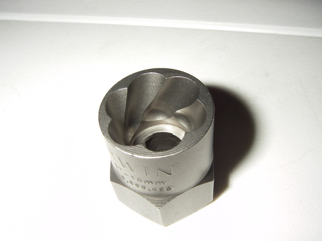

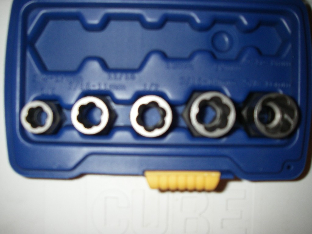

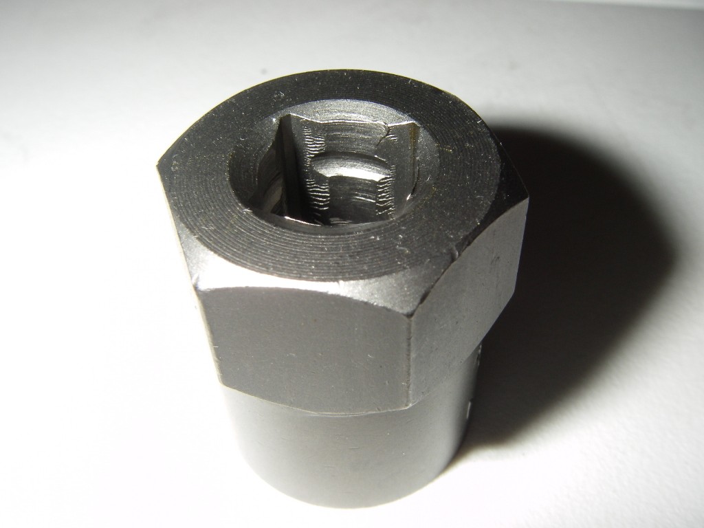

This is what I use to remove rounded off bolt heads...
Attached Thumbnails Broken wheel lock key..-a1.jpg   Broken wheel lock key..-a5.jpg   Broken wheel lock key..-a6.jpg
