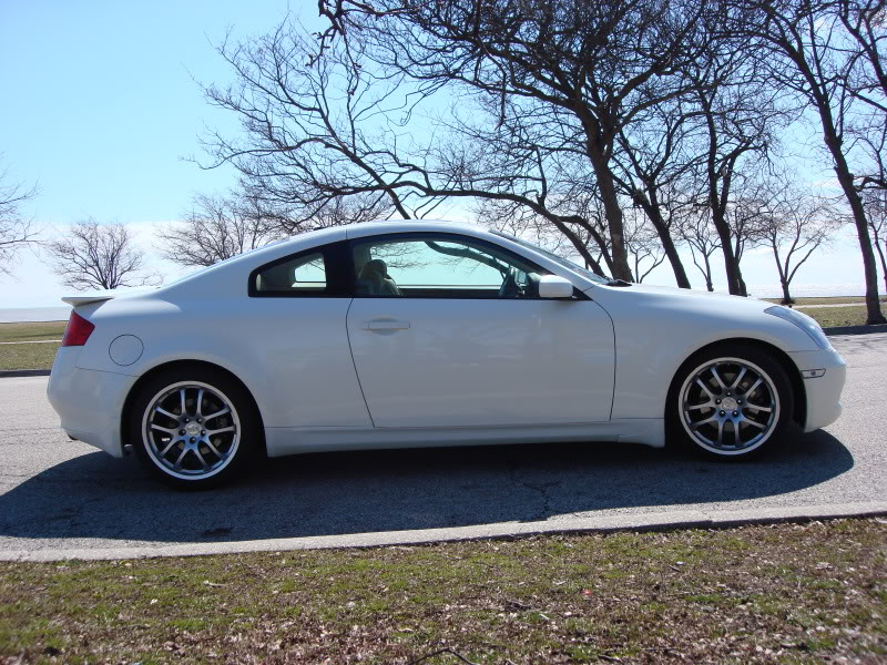

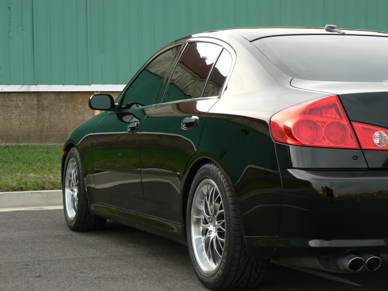

Here are a couple of pics I found after Z Springs were installed:
Attached Thumbnails Quick Question For My Local Guys...-g35-on-350z-springs.jpg   Quick Question For My Local Guys...-g-coupe-on-350z-springs.jpg
