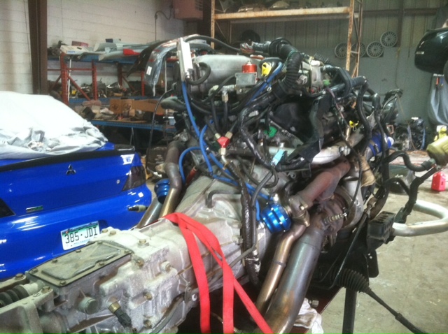

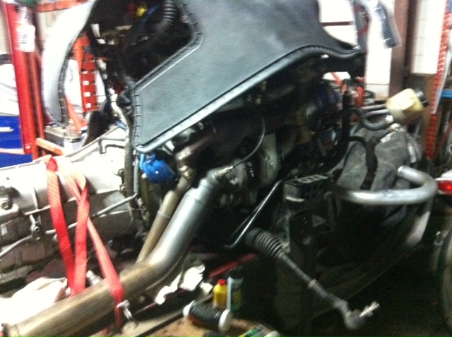

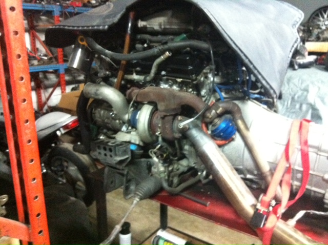

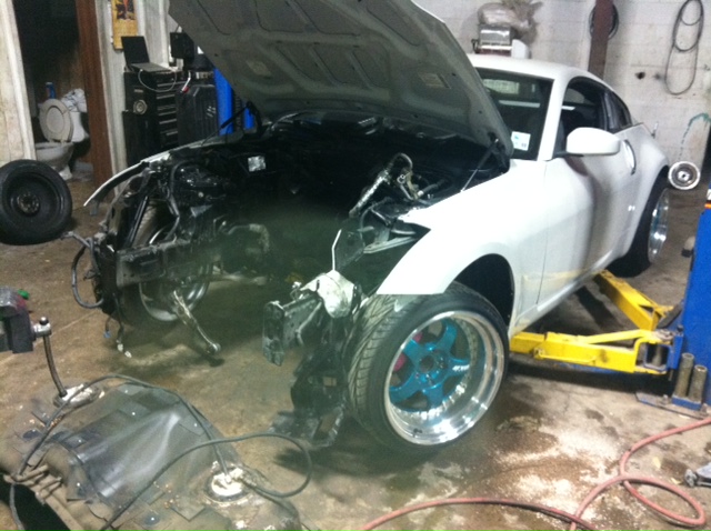

well i started the grey ghost 600hp swap today. got some pics now

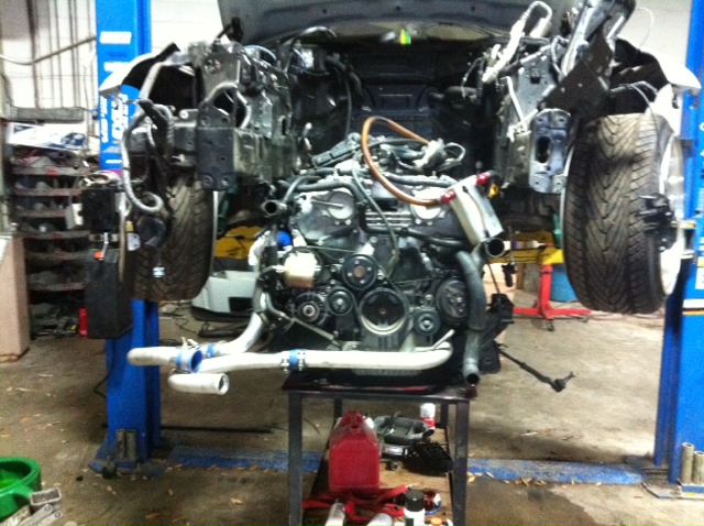

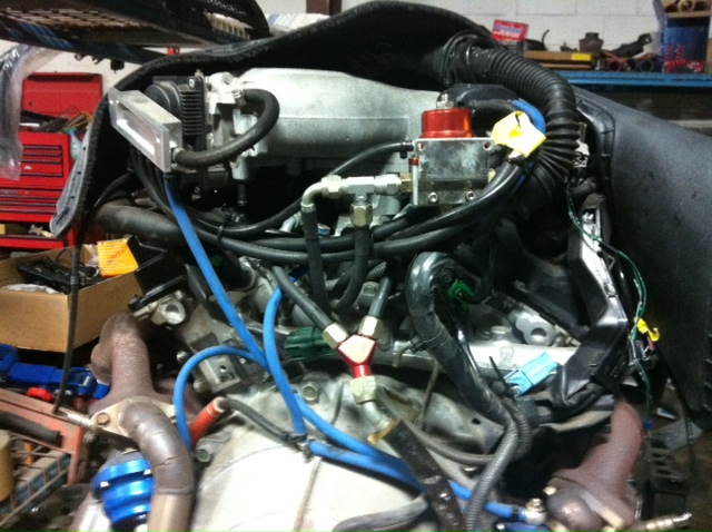

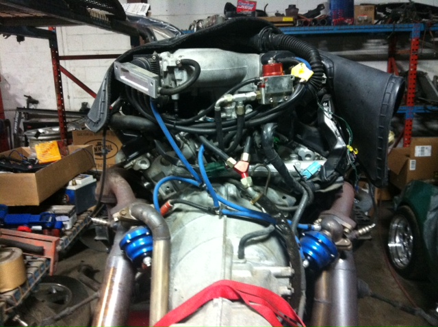

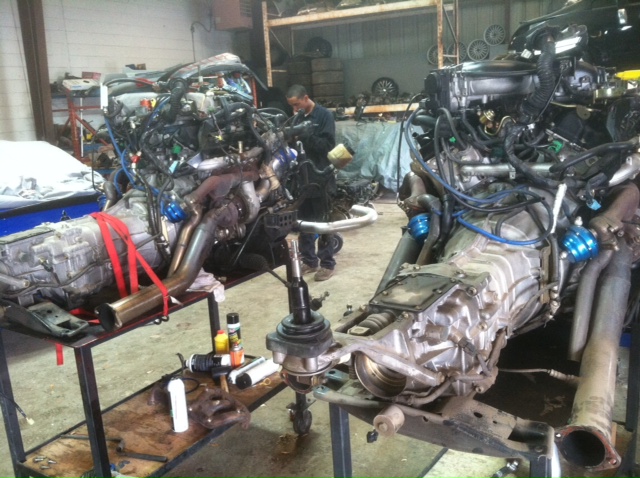

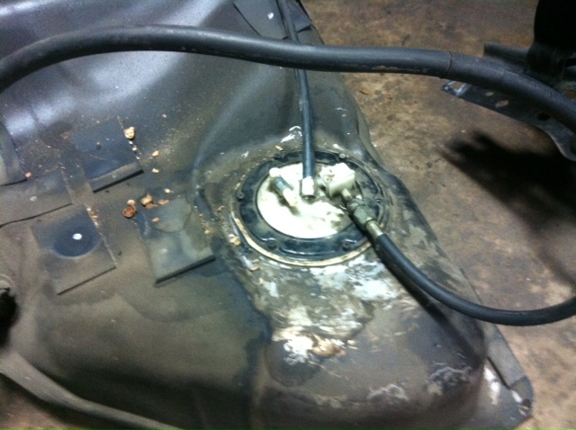

some more pics. had to swap out gas tanks, z now has return fuel setup now
how often do you see two greddy turbo complete swaps like side by side
the one on the left is 592hp built setup, right engine stock with greedy tt setup

just installed the return line setup late last night, engine swap next!!!

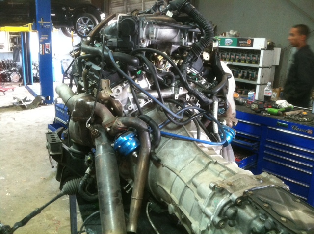

going back in with the good stuff
je 8.8:1 pistons
eagle rods
jwt c2 cams
hks headgaskets
greddy 18g tt kit
tial bov
koyo raditor
aam 3" downpipe w/dumps
ats twin carbon clutch
