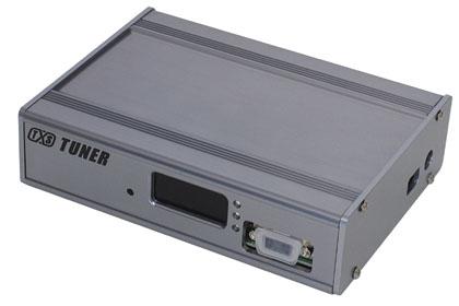

This one.
http://www.turboxs.com/more_info.php?ID=198
I believe it is the only one that will allow you to datalog with the UTEC.

Only the UTEC WB works, and mine doesnt look like the one pictured above. I did read that one guy somehow made an AEM work in the FI section of the boards...
