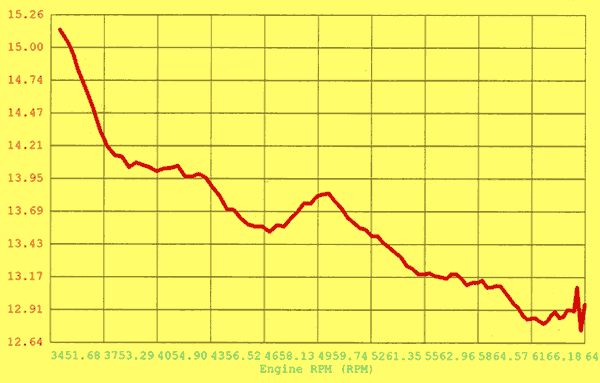

Most dyno shops have expensive A/F wideband units.Some range from $500-$1200. I would trust their A/F readings over an $80 factory narrowband O2 sensor any day.

Haven't dynoed my car anywhere else but the one place, do they all depend on tailpipe sniffers on one side of the exhaust? This was the AFR that was read on my stock Z...does it look accurate?
