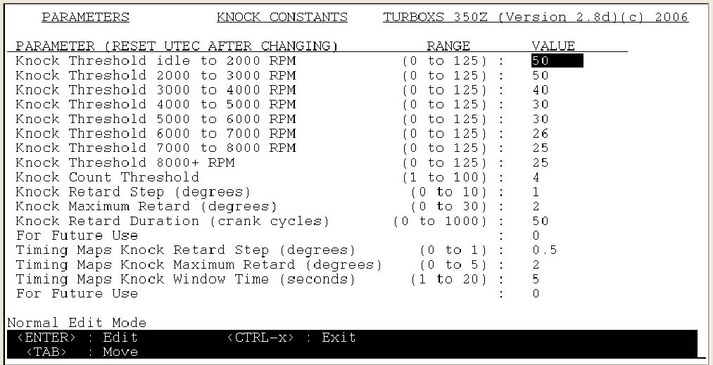

Yeah, here's mine.

That is some pretty conservative knock threshold and I believe you didnt change what came with Utec. I believe mine is set about 75@4000-5000 and 65@5000-7000 and I thought that was already conservative.. lol

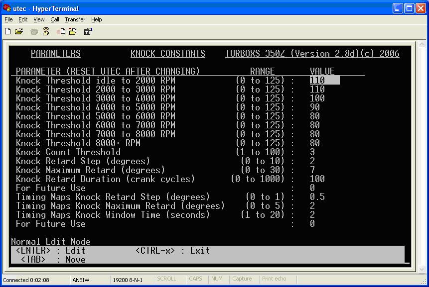

Haha, my car has so much mechanical noise. These are the settings that Sharif set on mine. He said if the dyno shows an increase in power and it knocks, its not real knock. or something to that effect. Either way, I trust his tune/judgment. Although I did put close to stock values in for my NA tune params

^^^ Jeez, with knock settings that low you might as well just turn the knock sensor off. It'll never hear anything anyway. Lol~
What do your logs look like? Probably not showing much knock either way I'd imagine, since shariff turned the knock values so low. I'd be careful with those settings, or you'll be taking him back some repeat business on a rebuild.
Anyway, not meant to be a slam, just a heads up. Glad you're happy with it.
