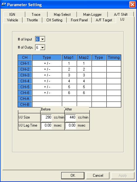

What do you mean by scale the EU for the new injectors? This is all what I did for the Injector sitting shown is the attached pic.

Originally Posted by sa@lol
OK i will cut the water temp wire.
That looks good (I think) ... now let me know how it goes after cutting the water temp
