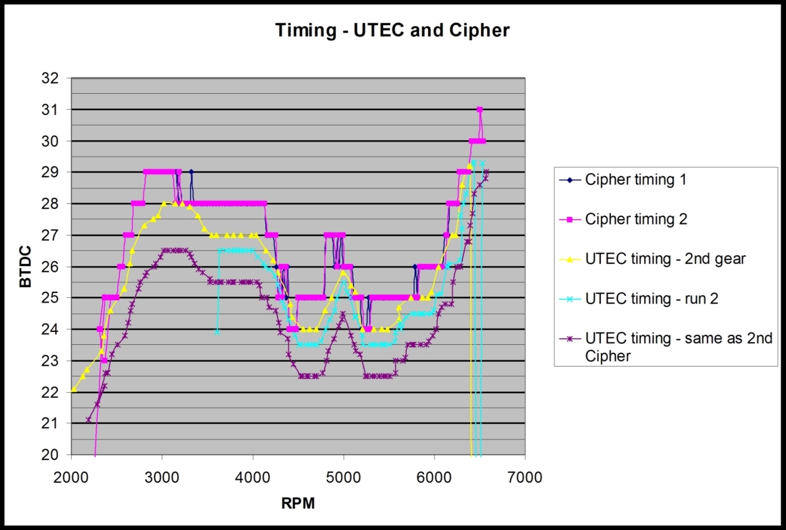

I believe the .5 degree difference is UTEC pulling your whole timing curve after detecting knock. I did some runs, and saw UTEC pull my timing curve each time because I was getting knock in the upper revs.
