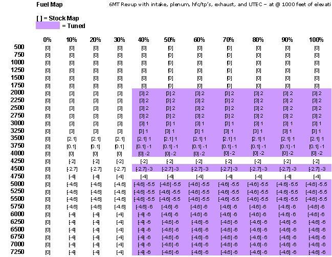

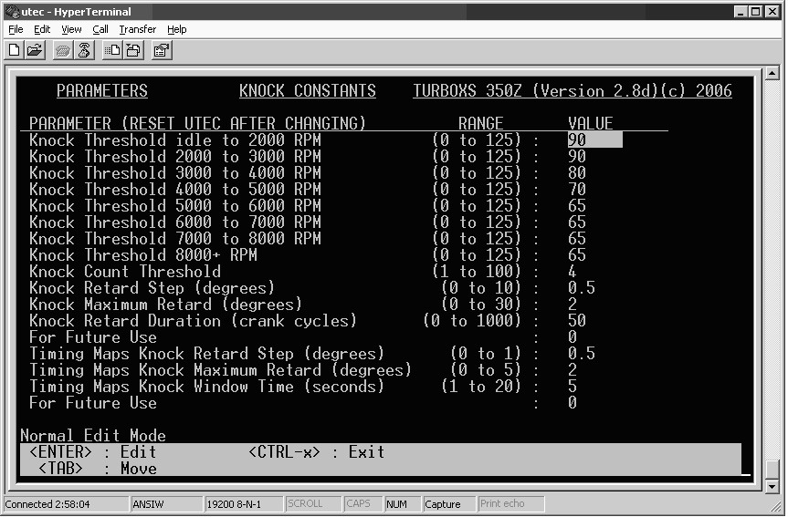

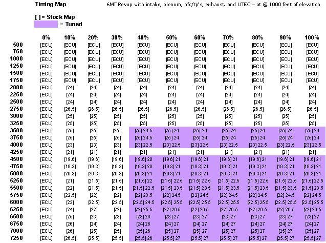

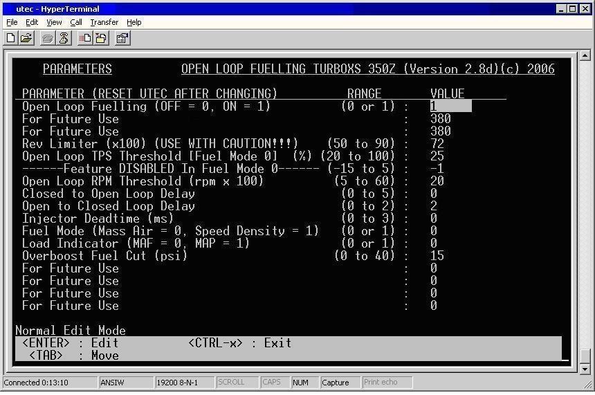

So I reset everything and went at it again. I took some runfiles after just playing with the AF and got a knock @6k so I went through everything and found no evidence that the ecu was pulling timing so I'm going to chalk it up to outside interference. I adjusted my knock setting and have attached them just make sure I didn't go to low. I ran a straight timing at a straight 23 from 2000-5500 and then went up one degree till 6500. Not sure how that fairs with what other people have but I just wanted a base line to monitor knock. Luckily after a few 0-80's and 3rd gear pulls I registered no knock.
Thoughts on the knock settings or timing values?
Old Jun 15, 2007 | 08:30 AM
gothchick's Avatar
gothchick
Posts: 3,300
From: ATL
Hmmm… Straight timing of 23 from 2000 to 5500 is too conservative in some places and too aggressive in other places.
If you have a 6MT NA Revup with intake, plenum, hfc/tp’s, exhaust, and UTEC – at @ 1000 feet of elevation, these tuned parameters will probably be what you’re looking for.
My tune is always evolving as I find new little tricks to fine-tune it even further. So I don’t mind sharing my findings and spreading knowledge of what worked and what didn’t.
So - I finally got my tune dialed in pretty tight across the spectrum and the car pulls way harder and more linier, than it ever did after being 'professionally' tuned in Atlanta... while still keeping it well within safe mechanical operating specs. I now have a permanent smile engraved on my face. :-)
Disclaimer: I am only providing these as examples of what worked best on my car. If you blow your **** up tweaking the parameters, it ain't my fault.... An AFR gauge and/or UTEC Tuner Module is indispensable when tuning. A dyno is also very helpful to provide feedback on hp & torque curves.
Attached Thumbnails Knock on shifting!-open-loop.jpg   Knock on shifting!-knock-constants-06022007.jpg   Knock on shifting!-timing-map.jpg   Knock on shifting!-fuel-map.jpg

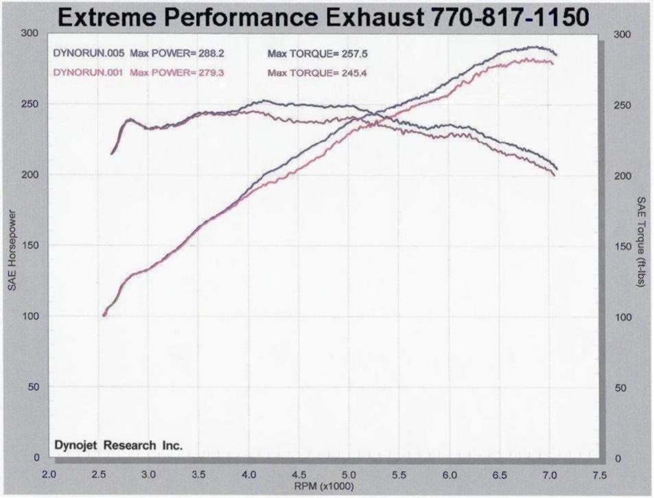

I know someone's gonna ask...
My highest current Dynojet number is 288whp using my 'self tuned' parameters.
My previous highest Dyno Dynamics number was 240whp using a 'professional tune'.
I still have the exact same mods from when I had the 'professional tune'.
Correcting my Dynojet number to a Dyno Dynamics number = 256.5whp... A delta of 16whp over the 'professional tune'.
But to be fair, the HKS exhaust the shop sold me had major blockage at the time they did the tune. And they also didn't utilize as much of the tunable spectrum as I did...
Yeah... girls can rock too... :-)

Good work. Just for clarification, an average DJ correction is about 10-13%, so you delta is smaller. I have seen as much as 16% increase with a DJ vs. DD. The only way to compare, is to use the same dyno, with similar ambient conditions. But definately looks like your blockage was choking off some power..and I am glad it feels better now.
Old Jun 19, 2007 | 06:31 AM
gothchick's Avatar
gothchick
Posts: 3,300
From: ATL
+1
The industry accepted value is 11%. So I used a DJ correction factor of 11%. This should put my numbers pretty close to the 16whp delta I calculated over the Marietta, GA 'professional' tune. :-)
For the sake of Clarity:
DJ 288whp * (.11) = DD 256whp.
DD 256whp (self tune) - DD 240whp (pro tune) = DD 16whp self tune gain
On the outside edge of the population distribution:
DJ 288whp * (.13) = DD 250whp.
DD 250whp (self tune) - DD 240whp (pro tune) = DD 10whp self tune gain
I even rounded the numbers down just to be conservative. But - Either way you calculate it... 10whp to 16whp is a good amount of self-tuned NA gain.
