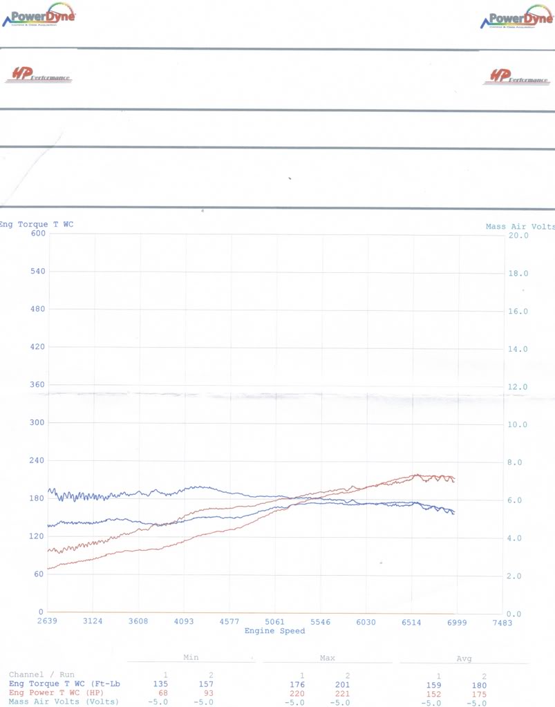

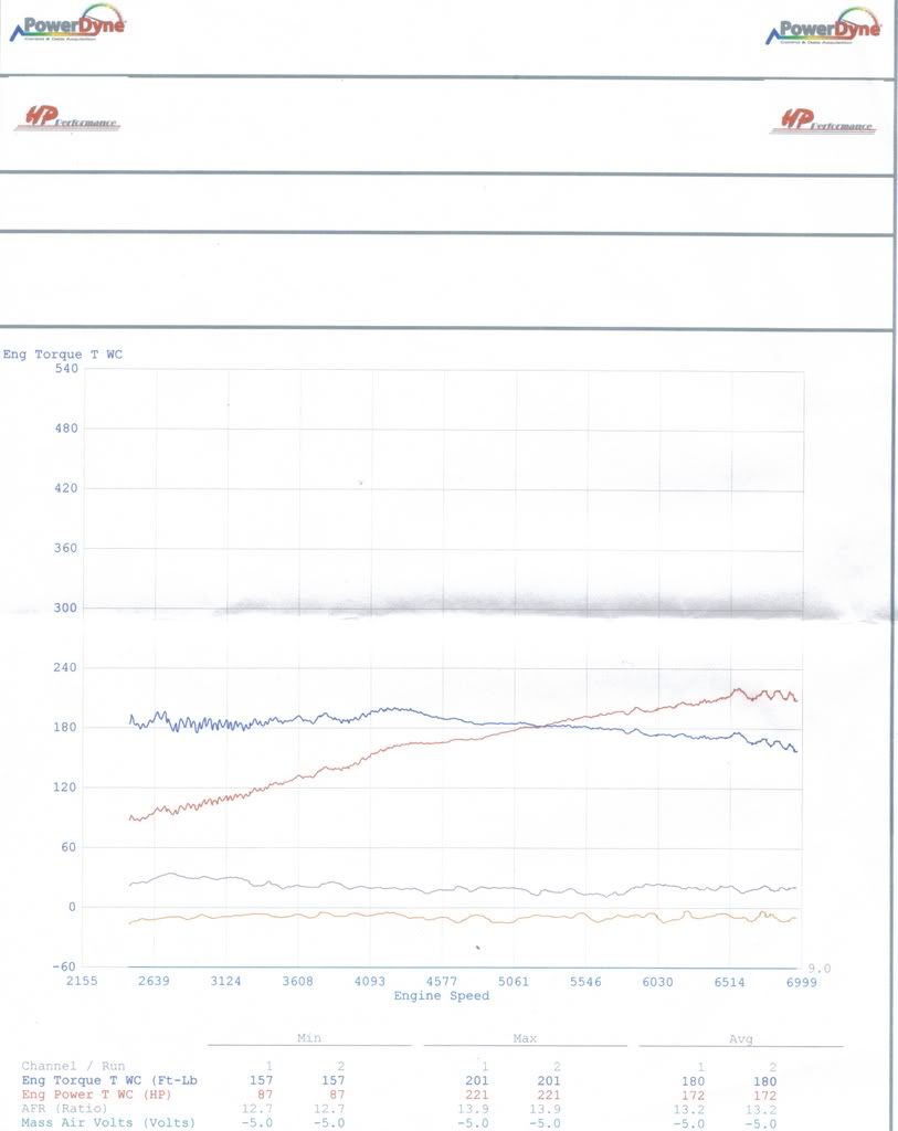

This is with the end user tunable version of osiris, not the map reflash version. A friend and I tuned it, it was not tuned on a dyno but on the road. It could be possible to get more power as the cheap muffler I had on it had something loose inside of it. 221whp on a mustang dyno isnt to bad for a low compression engine though (at 3800ft elevation). I have never seen a dyno of one without forced induction. So now when I do turbo it I will see how much power I actually gain over a stock built engine. I could possibly gain 5whp with some tinkering but I am not sure it would be worth it haha.
Unplugging the exhaust cams on the dyno has showed me that they are there for more than just a EGR function which I was led to believe. The power loss on the dyno shows this. For some reason the power was smoother with them unplugged. These dynos pulls were done about 10-15s mins apart.
If you want to laugh at my low hp numbers I really dont care.
First dyno with cams plugged in.

2nd dyno with cams unplugged.

thanks for doing the comparison and also for give us an idea of what a low compression VQ35 will be vs the normal compression, but please can you tell us what is your compression exactly, thanks again.

the version i have of osiris is the beta. its not available for purchase at this point in time. i may redyno it in a few weeks when im finished with my exhaust. i may also redesign my air intake.
my engine is 9.1 compression with arias ed pistons. i also have right at 24k miles on it. its still running strong and waiting for boost.

I really thought there would be more interest in this, after reading peoples various theories about the variable cams. I may take my car down to uprev when i get the extra money and let them play with the cams on the dyno. I have access to the camshaft tables but I am not that advanced in tuning and do not feel i have the knowledge to tune variable cams. Tuning a/f ratio and timing is no problem though.
I have been thinking it might be possible to sit the exhaust cam in a fixed state after 6400 rpms as that looks like where the ecu kind of freaks out. Setting it at a 0 degree position would probably fix this and the engine would be smoother in the higher rpms.

On the revup you can just unplug the cam connectors on the heads, and it sets them in a 0 degree fixed position and they dont move. The map reflash you guys can buy doesnt have cam timing built in, that i am aware of. I have a different version once again that has access to real time tuning ( and i have access to the cam tables but only the intake cam). The cam tables are in the reflash tool I have, not in the real time tuning so have to make adjustments then reflash to change those settings.
The 2005 and 2006 have factory wideband sensors, that the real time tuning software reads from. This makes it very easy to tune the car, way easier than a utec.
I tuned my base file, uprev did not. I have not tried any of thier pre made maps either. This tune was done on my own, on some backroads. I have had the real time tuning version since late april. Its still in beta and i am not sure when the release date is.
Cipher will log the intake and exhaust cam angles. I have talked to uprev and they are going to set my exhaust cam to sit at 0 degrees after 5800 rpms this should correct the problem and ill verify it on the dyno.

If i were you i would wait for the end user tunable version of Osiris, it really is great for tuning. Unplugging the cams wont do anything bad for your engine except make you lose power .

it seems that the variable intake cam is used to advance the cam for more top end power, while the ECU uses the variable exhaust cam timing to retard the exhaust timing for better low end performance.
