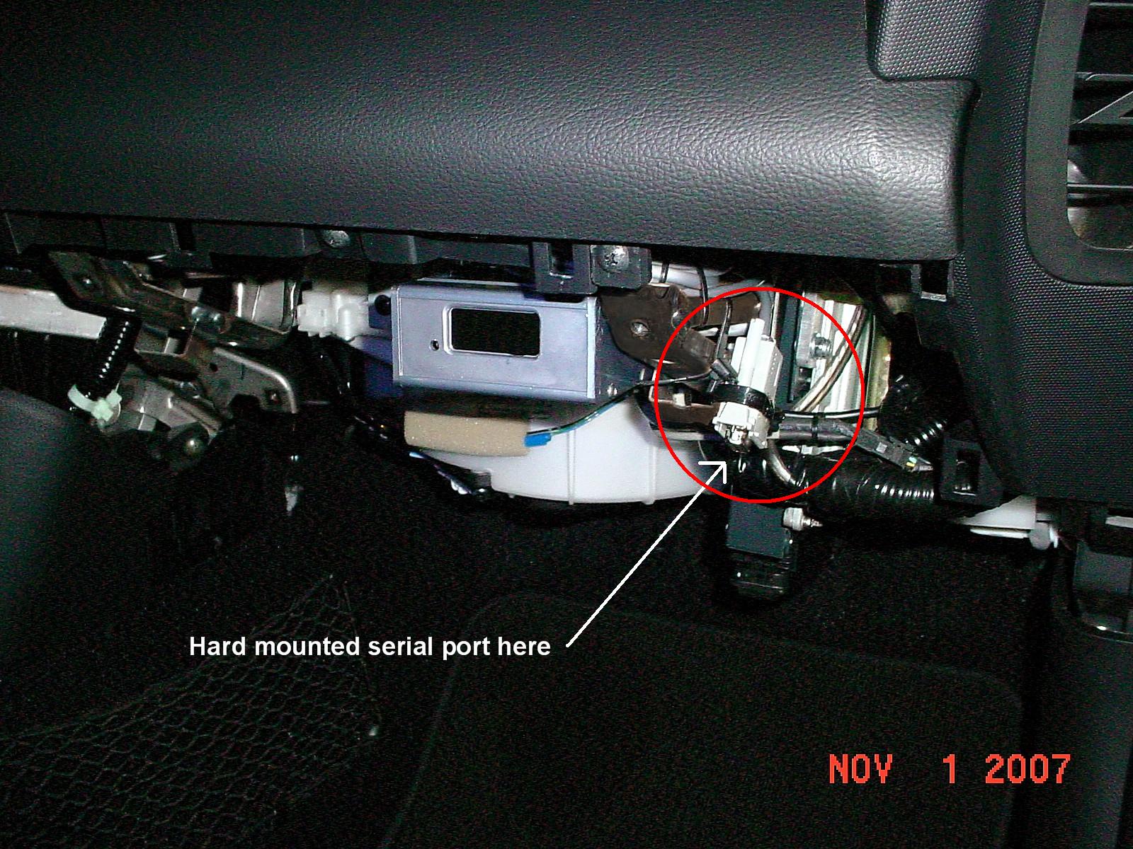

You basically log into the Tuna. From there you can flip between Utec maps or Tuna parameters. Logging and Dashboard functionality integrates Utec & Tuna into one output.

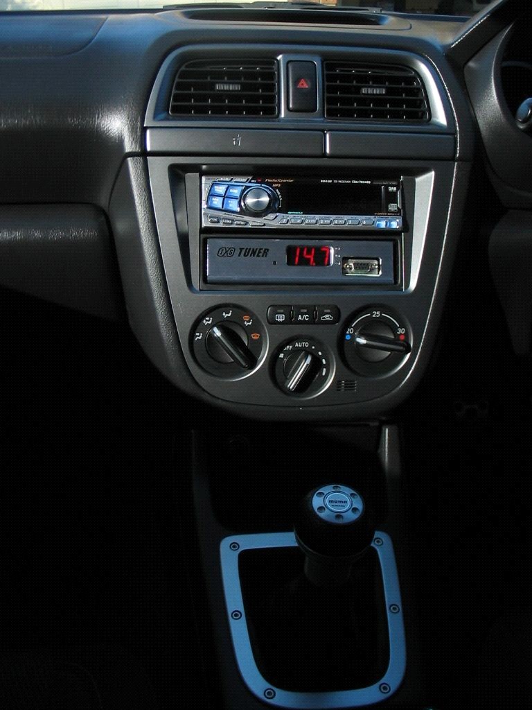

Here's how one Subby guy installed his Tuna Pro. I did something similar, integrating it into my passenger side dash... I even fabricated a hard-serial mounting point (kinda like an OBD2 port). Pretty slick.

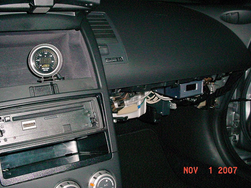

I originally ran my AEM AFR gauge off the Tuner... But then ended up running the AEM off Bank 1, and the Tuner off Bank 2.
It's kinda cool to watch the two banks AFR's fluctuate a little in relation to each other when I'm just tooling around town (ecu controlled). Bank 2 will run a little lean, then bank 1, then back to bank 2...
But when I nail it and Utec takes over, the Tuner & AEM are pretty much dead-on in synch with each other... Which leads me to the opinion that the factory ecu is sloppy.
