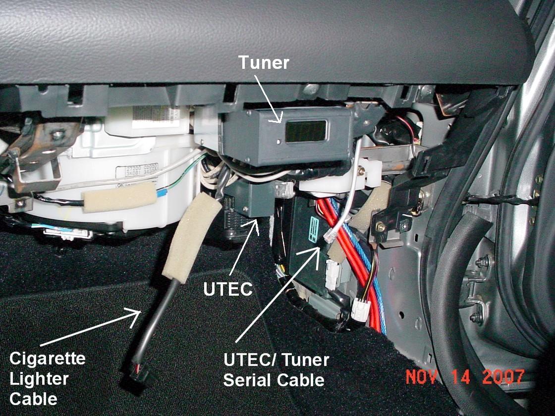

Alright, here are the pictures of how I mounted it...
Gotta love MS Paint

Okay, I see how you're doing it. I mounted mine to the opposite side of the ECU that you're trying to mount to. Not sure how that'd fit though without the mounting brackets... I'd call TXS about the mounting hardware. I've noticed they're more responsive to phone calls than email. But they are very helpful when you get ahold of them~

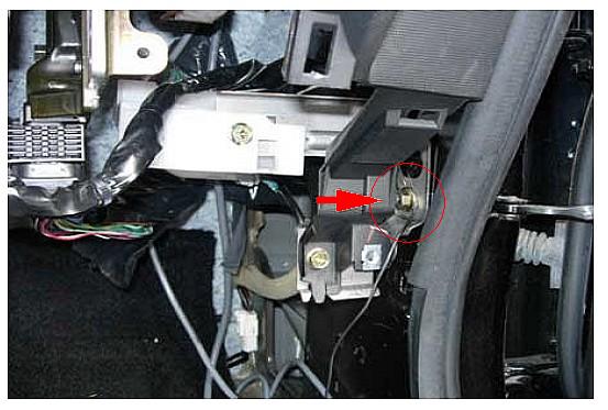

Hey, don't forget to ground your UTEC to the *chassis*. It makes a difference!
Also, if ya wanna lose some weight, get rid of that metal plate underneath the passenger side dash. That thing is kinda heavy. :-)
Chassis grounding point:
Attached Thumbnails best way to mount utec?-utec-and-ecu-grounding-point.jpg
