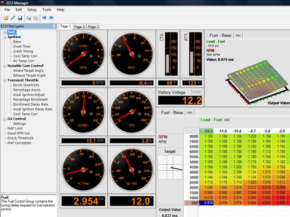

This is what I am currently seeing on my Haltech. Right now the car starts and then cuts off.

Regarding the AFR difference - have you set the calibration in the Haltech ECU Manager for the AEM wideband? It defaults to OEM Nissan cal.
If the tune is appropriate for the car and it is just a starting issue, then use Post Start Fuel Enrich under Fuel.

Thanks Hal I called Injected and they said you were out today. Im having fun trying to understand whats going on with the car if the tuning was as sucessful as the install I would be in shape lol
I do not understand where to change this. I looked on the Haltech website for installing the AEM UEGO and tried to set those values on the Haltech.
The car cranks to 1500 rpm and then dies. I'm trying to understand which cell should be increased or decreased.

I am not certain where on Haltech's website you looked... but you will need the AEM calibration information and enter it into the appropriate spot in the ECU Manager. This has changed depending on version, but most recently it is found under Main Setup 'O2 Wideband 1' and 'O2 Wideband 2'
As for post start, it is under the Fuel tree. Follow the blue dot when you start the car and beef that up. Again this will only work if the tune is off on post-start only. For cranking, see cranking. For warmup, see Fuel - Coolant Temp Corr. For warmed up, see Fuel - Base.

AEM UEGO Calibration:
Linear:
0v = 10afr
5v = 20afr
Old Oct 9, 2009 | 01:48 PM

In the car now. When I look at the O2 config its is at:
0v = 10afr
5v = 20afr
Went to the fuel tree and stared to gradually richen some of the cells. I followed the blue dot riched some of those and its doing the same thing. In the injector coloum it says i have 600 injectors when I have a diffrent injector.
