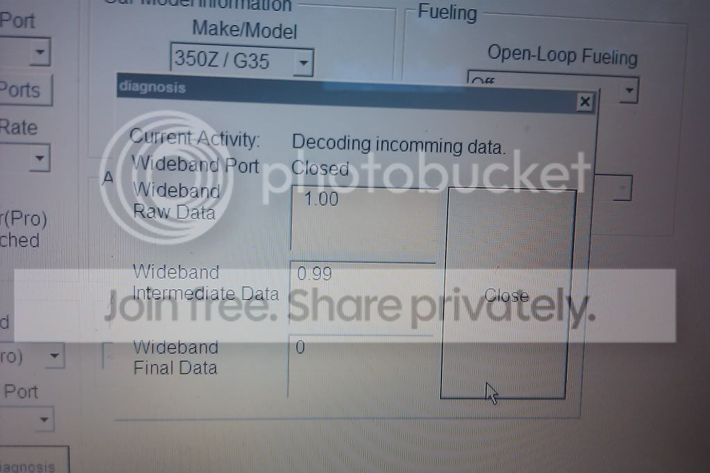

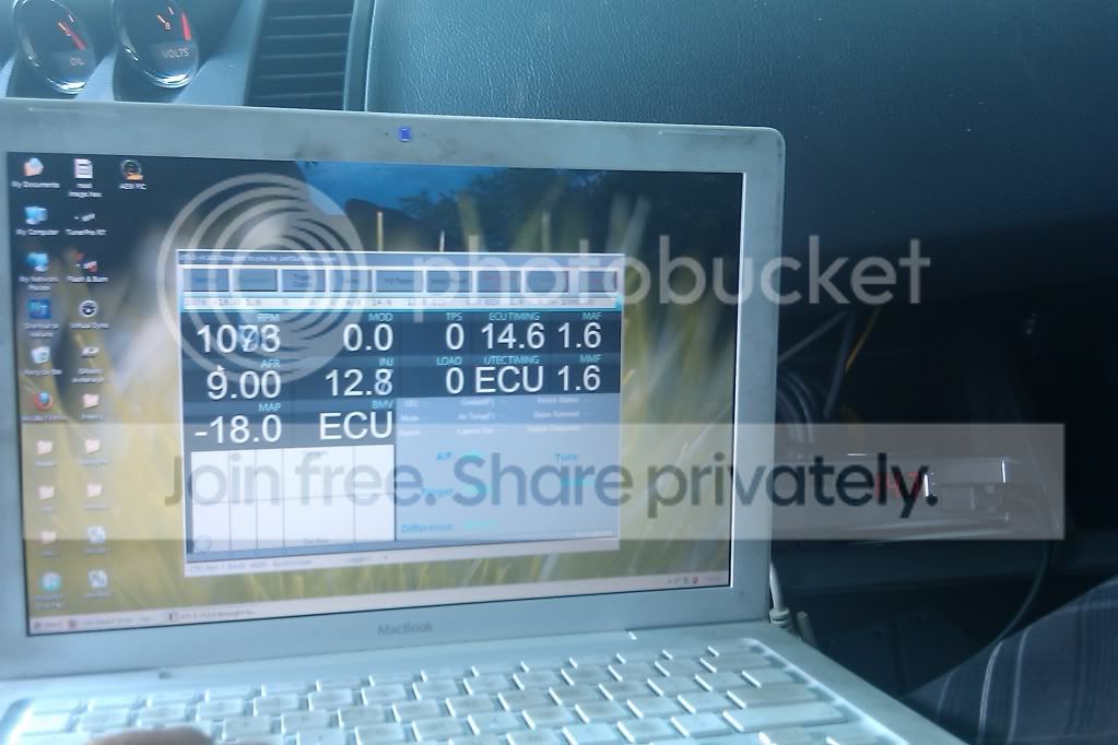

The tuner pro is displaying the correct A/F but, the Jeffsoftware GUI is not displaying the correct numbers in real time? How do I get the Jeffsoftware to show the A/F? I know it was a known issue with the Jeffsoftware displaying the A/F in the Gui and usually just reads 14.7. However in the second screen shot the A/F does show in Lambda numbers and seems to show the correct readings. They change if I step on the gas.
First image showing A/F at 9 (usualy says 14.7)
Here is the Lambda numbers they seem to work in real time.
It seems like the tuner is not giving the utec the a/f reading and maybe that is why the jeffsoftware doesn't display it. But the Lambda is showing correct.
Anyone know of a fix or do I need a software bug fix from jeffsoftware?

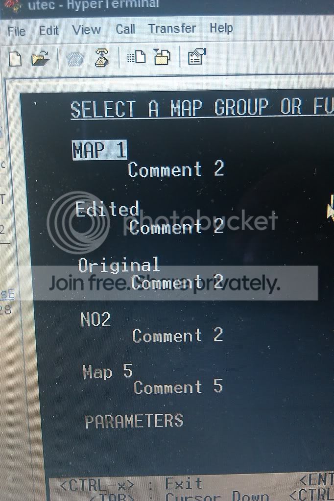

The second problem I was having is map 2 and map 4 are not showing that they can be used in the Dashboard even if I set it on the remote map switch.
anytime I set the map to map 2 the dashboard in hyperterminal says it is not map 2. I did have a checksome error on that map when we tried to load it.
Did I corrupt something in the utec? Or the actual map. Tried to fix it and it says it took the map but it keeps skipping map 2 and 4.
Any ideas?
