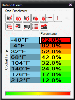

Here is mine. I am running DW 600CC and a Hpx PMAS. All Values are in Decimal format.
Latencies:
KFuel:
Op as for you startup AFR's on starting:
I have had to adjust these values for both my starting and idling issue. I have been taking with Jared, and he has given me some good pointers. I have also adjusted my starting enrichment table. This is a Extra Percentage of fuel that is added during the starting cycle based on Engine/Coolant Temp.
I hope this helps you out some OP.
Starting Enrichment:
I really wish we had a place on here where we could share ROM file info. Please remember to never use a ROM file that is not for your ECM. It will Brick it. I have seen a member on here do that. The ROMs are unique for the ECM model.
Attached Thumbnails How can I fix my lean warm up cycle w/ osiris??-latencies.gif   How can I fix my lean warm up cycle w/ osiris??-kfuel.gif   How can I fix my lean warm up cycle w/ osiris??-cranking.gif   How can I fix my lean warm up cycle w/ osiris??-fuel_compensation.gif
