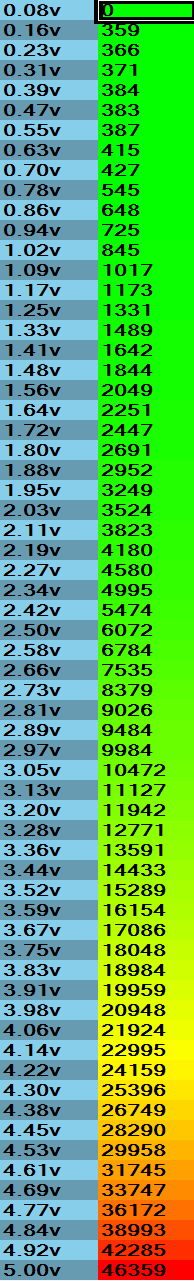

Very nice djamps. Whats your MAF Table look like? I re-did min with these steps.
1 . I re-did the Static Injector values with what you posted.
K: 37120
ILA: 135
ILS: 123
IMEPW: 1.5ms
2. Re-added the PMAS by selecting MAF on the static table and apply.
attached is my MAF Table.
I cannot thank you enough for all your help input. I am still learning and both you (djamps) and Vince are very helpful.
This whole injector scaling/PMAS is new to me.
Chad

I don't have my cable on me now so I can't load up the ROM editor and copy the MAF table. But from what I am reading PMAS varies greatly from PMAS to PMAS so you are probably better off starting from the map that Uprev provides. If you follow the procedure I mentioned you should have startup/idle nailed down in 3-4 flashes, and low load driving in another 3-4 flashes. Today I adjusted the MAF in the boost areas (>2.6V on my chart) so my entire fuel comp table is within +/- 5% even in boost. I would even say it drives better than stock now.
Interestingly enough I've found MAF tuning to be easier for street tuning without a dyno because you can do it from just the Cypher logs and rom-editor. Once you get the MAF dialed in everything else just falls in place.
