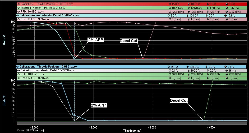

Alright I did some testing today. Here is what I have concluded:
Decel cut is based on APP, not TPS. I know this because I have logged many cases where the Decel cut activates, despite the TPS still reading above 2% (2% is my what my threshold is set to). I know it says "Throttle Value" in the ecu manager but I promise you, it is using APP. If you don't believe me, do some datalogs.
The second thing I have concluded is that my problem is definitely being caused by the "Injection Time Threshold" setting. If I set the threshold to 1.5 ms, the decel cut will activate right about 0.5 seconds after the APP drops below 2%. This is exactly what should happen, because the time "Delay to Fuel Cut" is set to 0.5 seconds.
However, if I set the "Injection Time Threshold" to 0.85 ms (the highest it can go while still allowing the cruise to work) then the delay between 2% APP and decel cut is more like 1.0 seconds. So it seems as though the "Injection Time Threshold" is what is causing the excessive delay between throttle lift and decel cut, because it should take no longer than the "Delay to Fuel Cut" setting, which is 0.5 seconds.
See the attached datalog for a comparison between 1.5 and 0.85 ms "Injection Time Threshold". Notice the time difference. This is repeatable every time.
What it comes down to is that the Haltech needs to be able to recognize when the cruise is engaged and prevent fuel cut from happening. Because an "Injection Time Threshold" of 0.85 ms is not high enough to have a proper decel cut. It sees the 0% APP when you take your foot off the throttle after engaging the cruise, and thinks it is time to go into decel cut - unless you set the "Injection Time Threshold" excessively low (lower than the stock ECU would ever call for when cruising).
At least that's what I believe to be true. What do you guys think?
Attached Thumbnails Haltech Burbles and Pops on Decel Transition-decel-cut-1.5-vs-.85-threshold.jpg
Old Sep 21, 2010 | 07:28 PM
  #45
mx594's Avatar
mx594
Posts: 608
From: Grand Rapids, MI
Originally Posted by midz350
This what was binder talking about:
As you can see, its in seconds.
No that's not what binder was talking about. Changing the "Delay to Fuel Cut" time wouldn't affect the cruise, only the "Injection Time Threshold" will cause that problem. Since he mentioned that it affected his cruise, and since he typed "ms" after every number in his post, I think it's safe to say he was talking about "Injection Time Threshold".
That said, he wasn't making any sense.

See the screenshot posted by midz350 above.
There are three conditions which must be met for the Haltech to activate decel cut.
1.Throttle Value - I believe this to be based on accelerator pedal position (APP), not throttle position (TPS). I have seen in my datalogs many instances where decel cut will activate when TPS is still above the Throttle Value setting.
2. Injection Time Threshold - This is the time in ms which the STOCK ECU injector pulsewidth must fall below to trigger decel fuel cut in the Haltech. Unfortunately, the Haltech does not allow logging of the stock pulsewidth. (In fact that just gave me and idea - I could log the stock pulsewidth with Cipher and see if it truly does fall below the threshold when I hit the cruise...)
3. Delay Till Fuel Cut - After both the above conditions are met the Haltech will wait this amount of time before activating decel cut. I am not sure if this time begins when condition 1 is met or when both 1 and 2 are met though.
When you activate the cruise control and take your foot off the pedal, the APP or "Throttle Value" goes to 0. So condition 1 is met. Now the only thing keeping the Haltech from thinking it's time for decel cut is the Injection Time Threshold. Thus, if this value is set too high the stock ECU may command an injector pulsewidth less than this value (when it is regulating the speed of the vehicle) and send the Haltech into decel cut. Once the cut happens, the stock computer sees the deceleration and applies more throttle (more throttle = more fuel) and the stock injection time rises above the Injection Time Threshold again and the decel cut stops momentarily before it happens all over again. That's why when you set the Injection Time Threshold too high, the cruise will cycle on-off-on-off about every .5 seconds.
At least that is what I believe to be true.

Originally Posted by binder
That's why i'm saying 2.5ms is way too high. Your injector pulsewidth will probably be lower than that all the time therefore never going into decel cut i would assume.
Dude, you are thinking of it backwards. Decel cut happens when the stock ecu pulsewidth falls BELOW the threshold. So if your Threshold is too low decel cut will be take longer to activate, as I proved in the datalog attached previously.
I have never heard of anyone raising the threshold to fix a cruise problem. If you had it too low it might cause problems with the cruise as well, but I don't know that for sure becuase I have never tried it.
I am using 2.0 ms right now, and on the highway I can get the cruise to work if I am not going down hill. If I activate the cruise and very carefully lift my foot off the throttle it will stay engaged, but if I try to lower my speed with the coast button or start going downhill, the stock ecu will output a pulsewidth of less than 2.0 ms and the car will go into it's on-off-on bucking cycle.
The best part about using 2.0 ms is that the car NEVER pops anymore, not even on rev matching downshifts. It sounds like stock and the gear changes are still smooth as can be. To me that is more important than a working cruise control, so I am going to leave it as is for now. I am gonig to contact Haltech and see what they have to say. If there was a way to make the threshold adjustable depending on whether or not the cruise "set" light was on, it would work much better I think.
