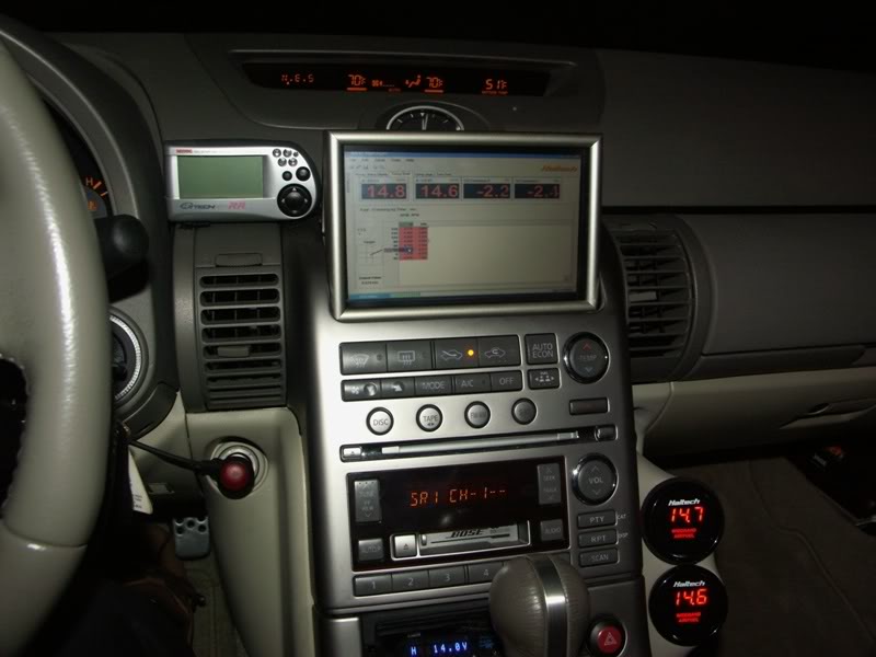

Old Aug 27, 2010 | 09:34 AM
rcdash's Avatar
rcdash
Joined: Jul 2005
Posts: 6,474
Likes: 65
From: Chapel Hill, NC
Yes it will go to high vacuum downhill. Like you said, the engine seems perfectly happy in the 16-18 range when there's no load.
The touchscreen is fantastic for gauge displays. It is very, very cool. The Haltech GUI is so flexible that the small display isn't that big a deal. Very easy to hit spacebar, P, and a number while driving to fine tune that fuel (probably better to have someone else drive!).
This was customized from a DigitalWheelz kit, but they don't make these anymore I don't think (you could check mp3car.com).
