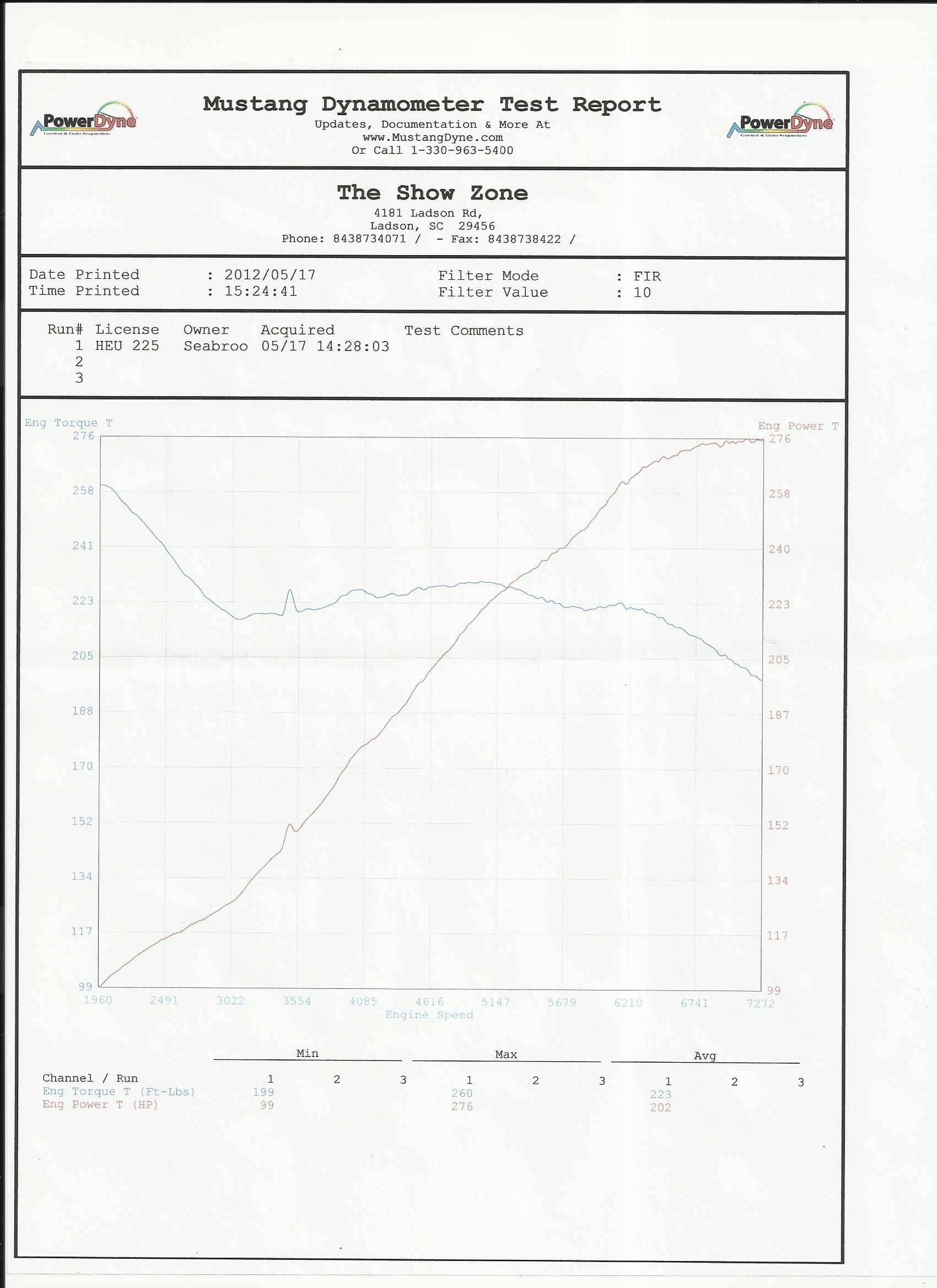

Well i got my car dyno tuned yesterday with the uprev software. its an 07 a/t . my only modification are art pipes, car feels great power delivery is very smooth , had the rev lmiter raised to 7200 rpm. my gas mileage also seems to have improved slightly.
my only gripe is i had my tuner clear the ses code but when i was driving home tonite the ses light came back on, he showed me how to clear codes using my laptop hopefully once i clear the code again this will be the end of it, that ses light drives me nuts lol.

Horsepower curve is very linear.
Torque falls AFTER 1960 RPM? I mean what engine reaches peak torque at 1960 RPM?

i'm not even gonna try and pretend that i fully understand the aspects of tuning and even half the stuff on that dyno sheet, all i can say is that the car pulls a lot harder and runs much smoother after the tune and im happy with the results
It's a problem of "dynotest" for sure, i don't know why sometimes happens.
Also in my car when i tried i have similar non-sense spike at very low rpm...
Simply doesn.t mind to that numbers under 2000rpm...

That torque curve is mind boggling.

Torque curve looks to be a problem with the fact it's an auto, they're not the easiest to dyno i would imagine.
yeah i think its just because the car is an automatic, the car pulls very nicely uptop and downlow so i don't think anything is wrong with the torque delivery knock on wood lol
