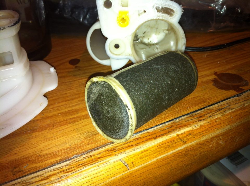

I found out incidentally that the 370z fuel pump is much larger than the HR pump. when I cut out my old fuel filter I found this (attached image). Im going to clean out the whole system, as I found sediment in the outlet of the sending unit.
