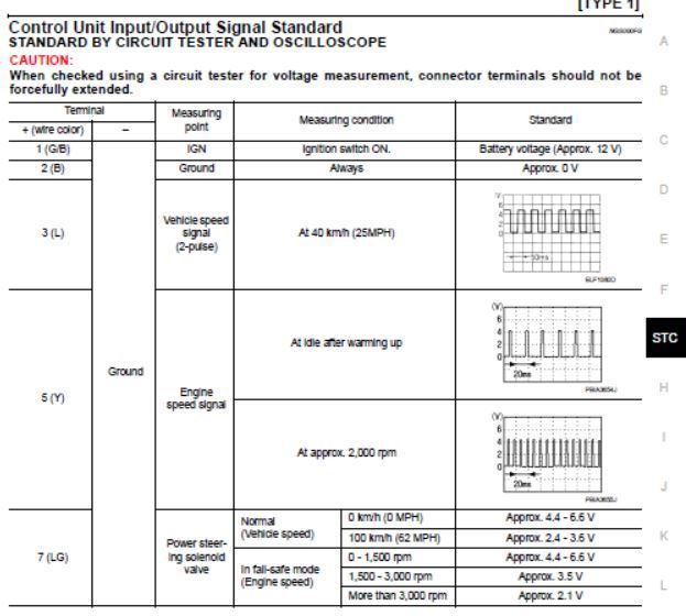

I know this is an old topic but I'm reviving it so there aren't multiple threads on the same topic.
I've had the Infinity for while and I've noticed a similar issue where the power steering seems to be stiffer/harder than when you have the OEM ECU, and I've confirmed it through testing. While I can't say that that the power steering is totally not functioning (because it is functioning and helping to certain degree) with the Infinity, its definitely not assisting as well as with the OEM ECU, particularly noticeable at low speed.
I've decided to live with it, but I was looking through the FSM recently and I think the power steering system is not an on/off thing per see; its assist can vary by speed via the Power Steering Control Unit. (See Steering Control Unit (STC) in the FSM for details...for reference my car is a 2006 Enthusiast); they call it the Electronically Controlled Power Steering System in the FSM.
Looking at the diagnostics for the Electronically Controlled Power Steering System (see pic below) it seems to show the assist varying depending on the speed of the vehicle, so what I'm thinking is that the Infinity for some reason or another is not adjusting to the speed of the car and is just providing a set amount of power steering support (which I'm thinking is set to a higher vehicle speed, as logically you probably want less steering help at a higher speed).
Does my logic make sense? Other Infinity guys chime in...
