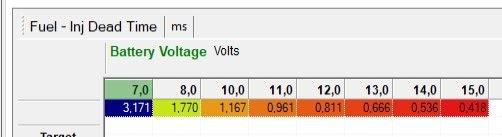

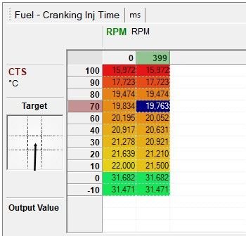

Hi All,
that is my first thread ever (everyone can check that in my statistic) so CK
take me for someone else.
Regarding the car, does not start on first start of the day (even in hot days).
If some other part are required, please let me know.
Regarding the Haltech on stock car........because I dream about twins in near future, I know it will be hard even painful if gone wrong but have to try.
Thanks to everyone that wiling to help.
