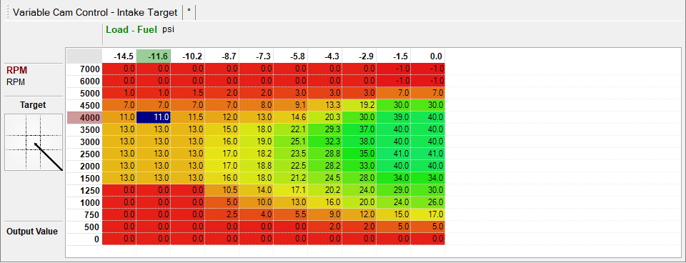

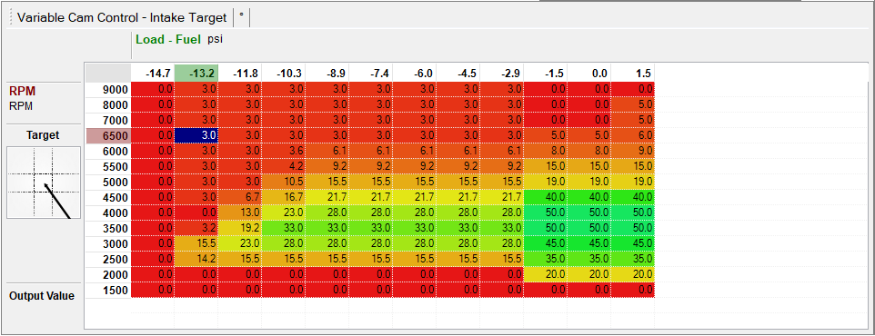

Ok here is my tuned cam phasing vs haltechs stock cam phasing.
Stock Map
Tuned Map
So it seems like my map isn't very linear at all and and stops on the higher end of of midway. I'm almost wanting to put the stock map on to see how much it changes the feel. Right now it feels like Meh until about 4-4.5k the exhaust pitch changes and the car feels like it has loads of torque. I doubt just changing cam phasing will do much or anything at all but worth a try.
If anyone has some more input LMK.

Why is your advance at 45 and 50 in some of the high load sections? Aren't the factory vtc pulleys limited to 40?

I have no idea why its that high, but yes i believe its limited to 40 for DE/Rev-Up and 50 for the HR's
Side note, does anyone know if the DE has the ability to retard the IVT Cams and not only advance them?
