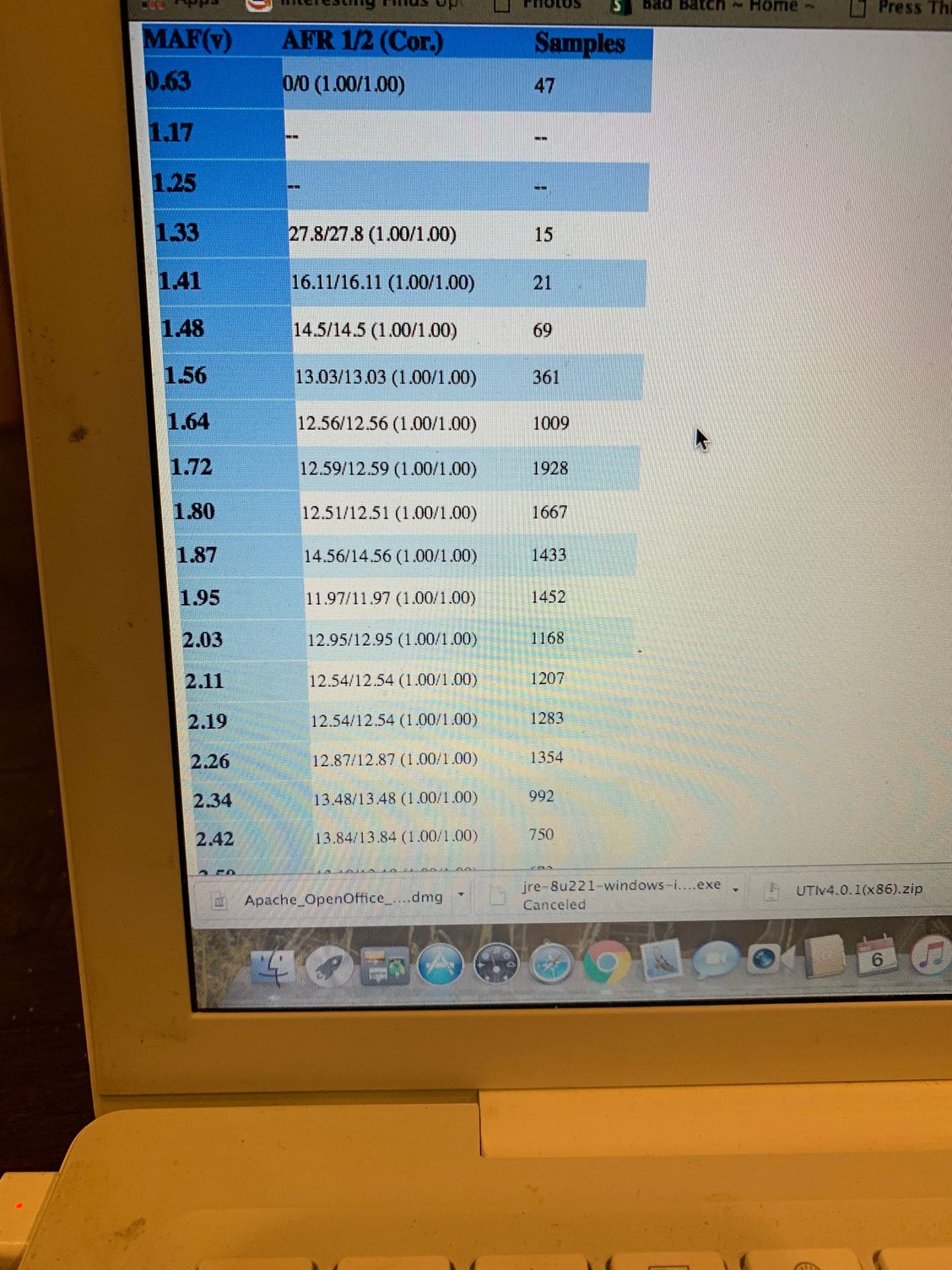

UpRev people can you help? Weird weird situation. My AFR corrections show 1.00/1.00. Both banks. No matter what. Not sure when it started or what caused it. Maybe I turned on a setting that caused this? I contacted UpRev but they won’t get back to me til Monday at the earliest I’m sure. Here’s a pic of a lot uploaded into DJAMPS tool showing what I’ve got going on.
Looks like you might be in open loop, so you wouldn't be getting any short term corrections. Idk if that tool shows you long terms corrections or not. Hard to tell without more info though.

I’m a moron... talked to a friend of mine who has a Z he tunes with Uprev. Runs a small dyno business. He told me that he had just been chasing something similar on his and found that he had accidentally set a couple cells that should be 14.70 in the target map to 14.04. Like he had hit the (-) button one to many times or something. Closed loop only occurs when it’s set to 14.70. So I looked. I had my whole cruising area set too all kinds of things that didn’t day 14.70. So I’m dumb is the moral of the story
