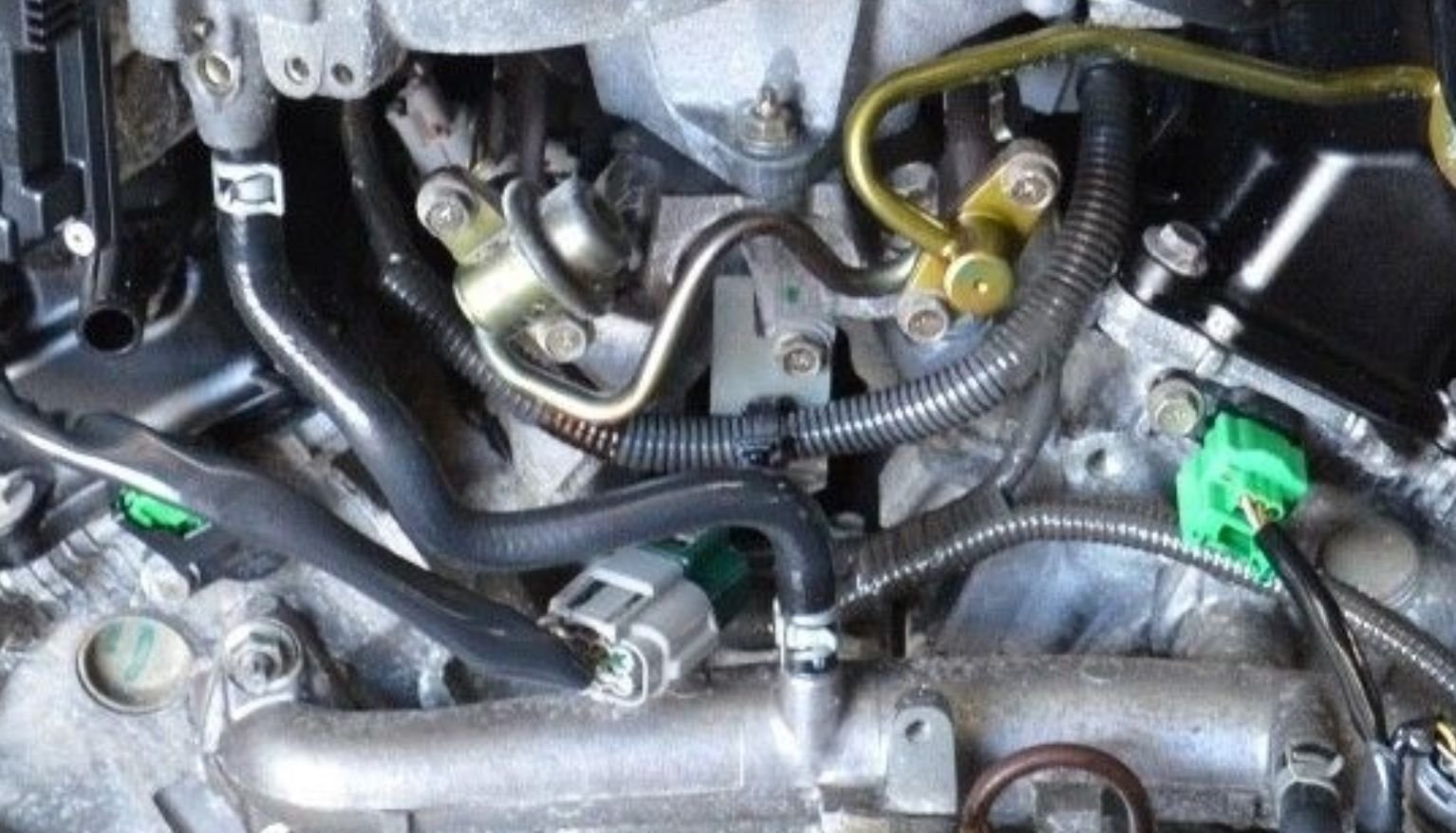

Here's a pic. You can either test for Ohms or replace- they're like $15.

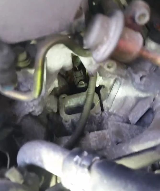

Did some poking around.
I'm going to try and fish the sub harness out, inspect and rebuild it with RG316 coax.
I may temporarly relocate the knock sensor. Then man-up and pull the intake.
I wonder if thats the oem sensor? Maybe it was replaced and it was the haress?

I'm seriously considering coming in from the back to get it out.

I managed to get the knock sensor out and replace it from the back of the engine.
I checked pin one on the harness, 4.7x volts.
Car is still a dog when its warm.
I'm going to remove and inspect the harnass next I guess.
wonder what else would throw a knock sensor code?
I just did the pedal dance, it seems to be ok but time will tell.
I'll update

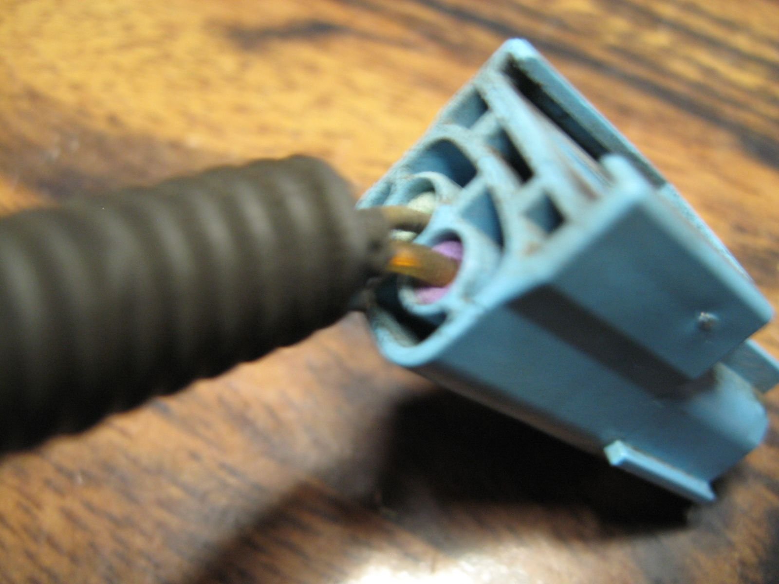

I got the harness out. I may buy more connectors and rebuild it.

So the verdict is: KNOCK SENSOR
I'm going to replace the sub harness as well because its brittle.
So no power, lagging throttle respone and P0327 or P0328 code that doesn't trip a cel light.

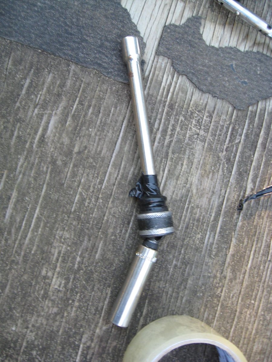

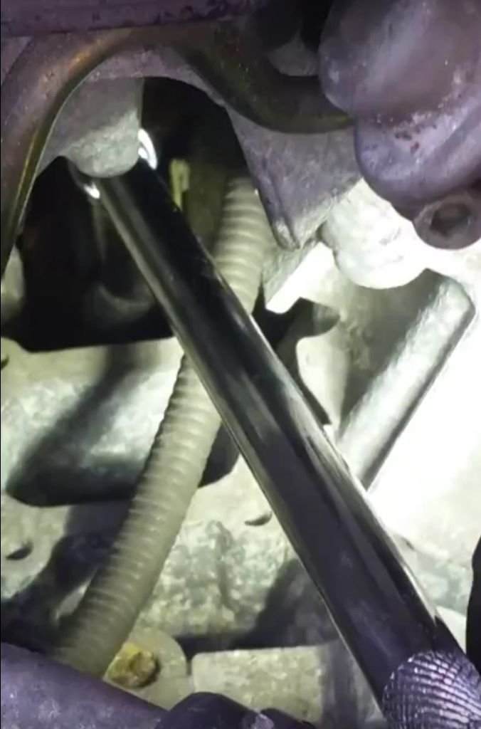

I ended up getting the knock sensor in from the front and got a socket on it from the back.
Car runs great.
NSFW words
This attatchment style was the one that was able to crack the bolt and retighten it.
the one above was better to get it started which was not too hard.
