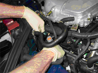

As of last night I know it works on 04 models with a build date of upto 10/03.
The key is to check your o2 sensor plug. There is one on the right (passenger) side of engine under hood. 4 wire plug are still flashable . . . 5 wire are not. Let me see if I have a picture of the plug around here.

Here is pic . . .sorry it sucks.
