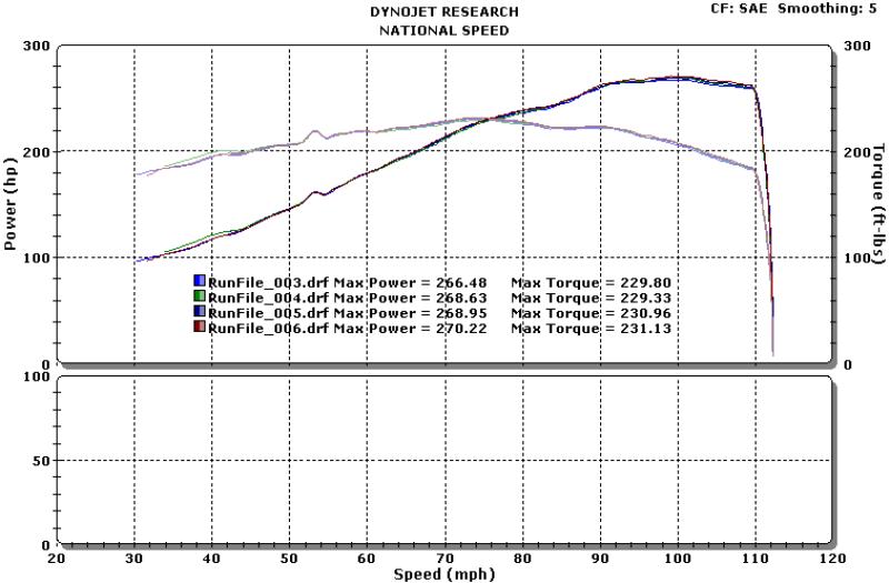

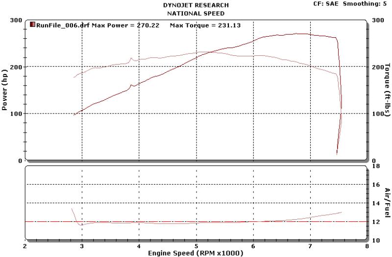

270 Wheel Horse Power and 231 ft. lbs. Torque

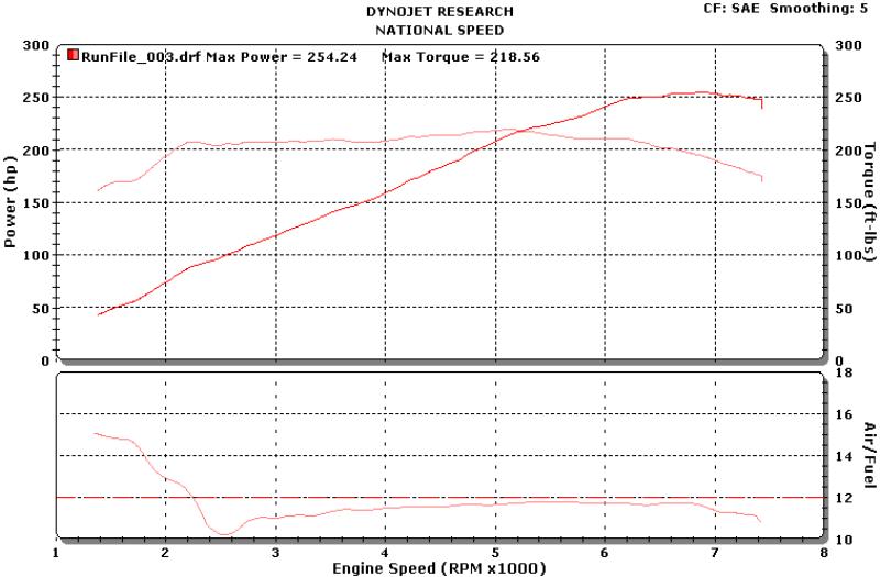

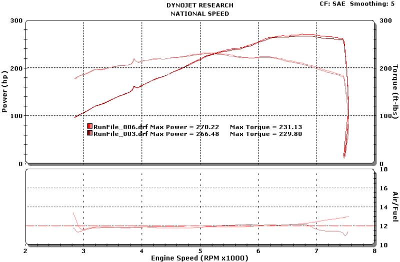

First Chart all my runs.....Second Chart Best Run.....Third Chart K&N drop in filters vs stock filters......Fourth Will's stock Nismo Z

Yep thats it.......Injen True Dual Exhaust and K&N drop in filters and 27% Humidity......so may be a little more on a good day........for an Automatic I feel like these are great numbers

4 whp gain with just the drop ins? Not bad. Not bad at all.

Yep.........could not believe it.......did 2 runs with stock filters....and 3 or 4 with k&ns

Did that Nismo dyno before/after you? Numbers seem low, if you guys dyno'd right after another, then you have some nice gains over him.
