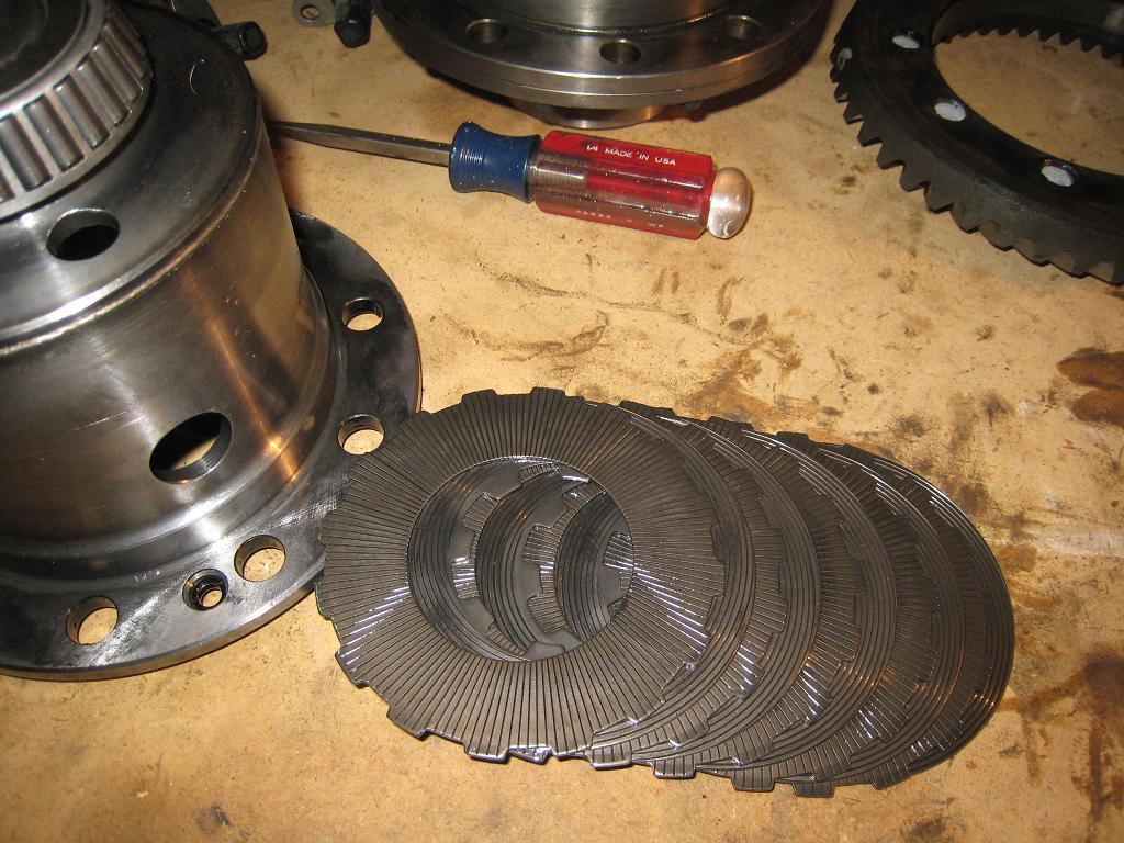

I went to an open lot and did figuar 8's this will shift the weight transfer from the left clutch pack to the right clutch pack. Do this for at least 10-15 minutes. Yes it will be loud clunking noise and this is just the clutches. Circles will not do the trick. You then change the fluid and you are done. It is not like a tranny clutch that requires a long break in period. Also remember the nismo comes 100% lock. I took mine apart and made it 80% for better feel at slow speeds. abababaabb center aabbababab the pic is the left clutch pack with it set at ababababab or 100%

Guys the preload it the adjustment you are reffering to not the % of lock. Look at the picture and you can see the % of lock from Nismo is 100% your preload is 60% and you can adjust the preload through the flange with it removed and set it at 100% preload but that does not mean when your preload is at 100% that you diff is 100%.
