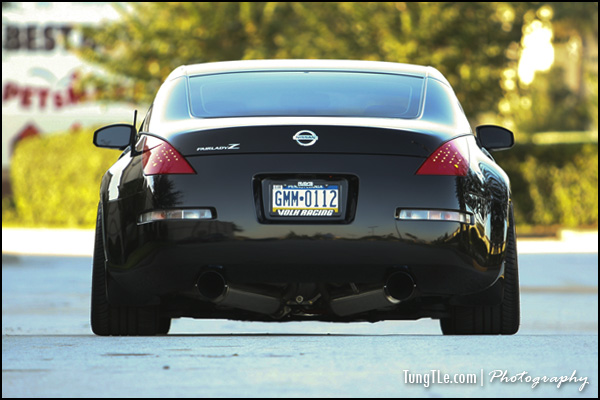

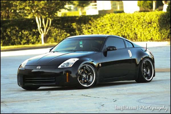

Here is my fair lady who wants some more Giiiiidy Up
